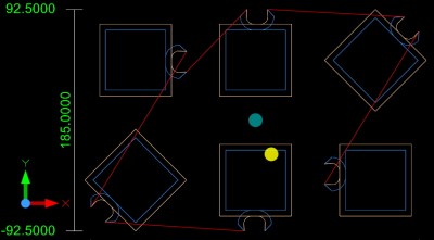

incorrect G41/42
Re: incorrect G41/42
Postby dezsoe » Thu Feb 04, 2021 6:29 pm
Could you please post the g-code of this test?
Postby hmnijp » Sat Feb 06, 2021 7:21 am
dezsoe wrote:Could you please post the g-code of this test?
here are these files
comp tests.zip
(82.24 KiB) Downloaded 631 times
hmnijp
Posts: 46
Joined: Sun Jan 17, 2021 12:59 am
Postby dezsoe » Mon Feb 08, 2021 12:36 pm
Sorry, I fogot to write thank you!
Postby cncdrive » Sat Apr 23, 2022 10:50 am
I just fixed this problem (except when starting with G19G3 arc, that is currently not handled by UCCNC, I mean parts in other than in G17 with compensation, will try to implement that later).

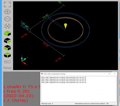

Postby 19Janusz53 » Sun Apr 24, 2022 6:33 pm
I have problem with G42 in loop.The view is OK, but the program only executes the first loop (Z = -2) and it goes around forever at this height.
The second problem is the messages that I don't understand and don't know how to remove.
I would like to add that without the G42 function, the whole thing works very well.
loop 24-04-22-G42.txt
(441 Bytes) Downloaded 454 times
