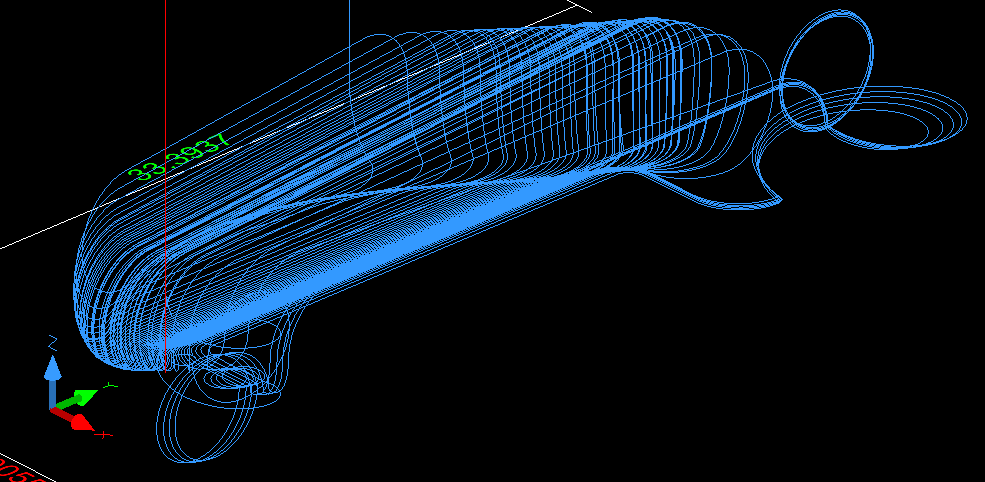

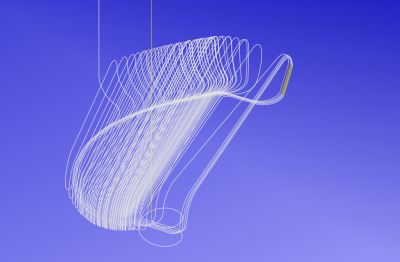

Postby fixebr » Tue Mar 01, 2022 1:25 pm
When opening the file, the wrong G-Code recognition is observed
I apply 2 screen - from the UCCNC window and from CIMCO, and the file TAP.
1 - 11 скругление.TAP
(74.23 KiB) Downloaded 337 times

Postby cncdrive » Tue Mar 01, 2022 5:10 pm
Your g-code has problems. Arcs in the code has different start and end radius which basically makes your arcs invalid.
However the UCCNC handles these cases, but your code still not good.
Mach3 do not even run your g-code file.

Postby fixebr » Tue Mar 01, 2022 5:45 pm
This code is generated in SolidCam, on a standard (basic) postprocessor. While the problem decided, replacing the arcs with the G17 etc on the G00.
But it seems strange to me that the standard code is not recognized by the program. Maybe there are some settings of the machine file so that such an error does not occur?
