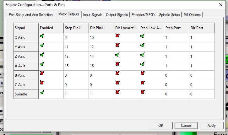

I am using 32 bit dsp digital 556 size drivers that show a max of 200khz. Wired per UCCNC drawings. What is the port and pin location for the spindle?

Re: AXBB-E mach 3 setup
Postby ger21 » Sat Mar 26, 2022 5:38 pm

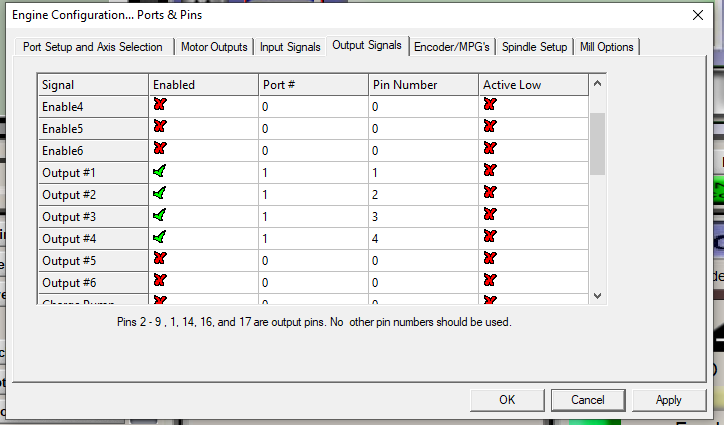

My guess is that you don't need to enter port and pin numbers for the spindle, if you are using analog speed control.
If you are using an output for a relay to start/stop the spindle, assign that pin to output 1, and assign output 1 to M3 (CW)

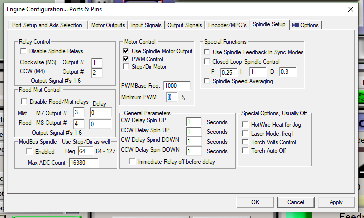

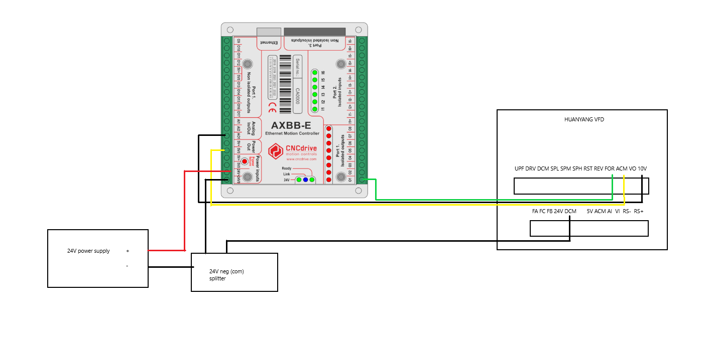

Correct I am wanting to control thru Mach 3. I have wired forward thru output 1, please see my settings attached. Also see my wiring diagram. So m I good to leave my settings as they are or do I need to make a change?
Thank you

I didn't know how close they were. I will definately read the it. Please see my wiring diagram in the post above. I do have a wire going to A01 per UCCNC recomendations. where is the 10v selector switch that some have suggested to change on the controller board?

Postby Dazp1976 » Sun Mar 27, 2022 1:34 am
gills wrote:
ger21 wrote:My guess is that you don't need to enter port and pin numbers for the spindle, if you are using analog speed control.
Thank you
It looks wrong. The 10v connection is the worry.
A01 usually goes to AVI on vfd (analog in). Check vfd manual for the correct input, it could be the AI one
5V0 goes to ACM (analog common).
The 10v is just a voltage output to deliver power to a potentiometer for manual 3 wire pot control.
I hope having the 10v vfd out going to the 5V0 hasn't damaged the axbb-e.
Inside the case of AXBB-E is a jumper. Open the case to switch between 5v and 10v out. Should be 0-10v range as standard though.
Please post your vfd's pdf manual.

Postby Dazp1976 » Sun Mar 27, 2022 9:42 am
^^^ To add to previous post:
http://www.mycncuk.com/threads/13016-He ... ller/page3
Look at the below link. Has diagram for a hy vfd.
Look at 10v, vi, acm. You'll see a resistor type deal connected to them. This is a pot.
10V is to power it, this gets regulated by dial and send via wiper to VI. Next you have the GND 3rd wire goes to ACM.
The WIPER is what you replace with the 0-10v output.
The 3rd wire GND is replaced by the 0-10v GND.
The controller supplies a regulated voltage so power is not needed to 10v.
The power supply input to the controller itself is technically the equivalent of replacing the 10v power.
That's how it works.
https://planet-cnc.com/controlling-spin ... put-board/
