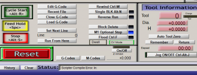

I have been using this same basic touch plate script for years. And now for some reason Mach 3 icannot read it and is giving me this script error message. I am running Windows 10 on my laptop

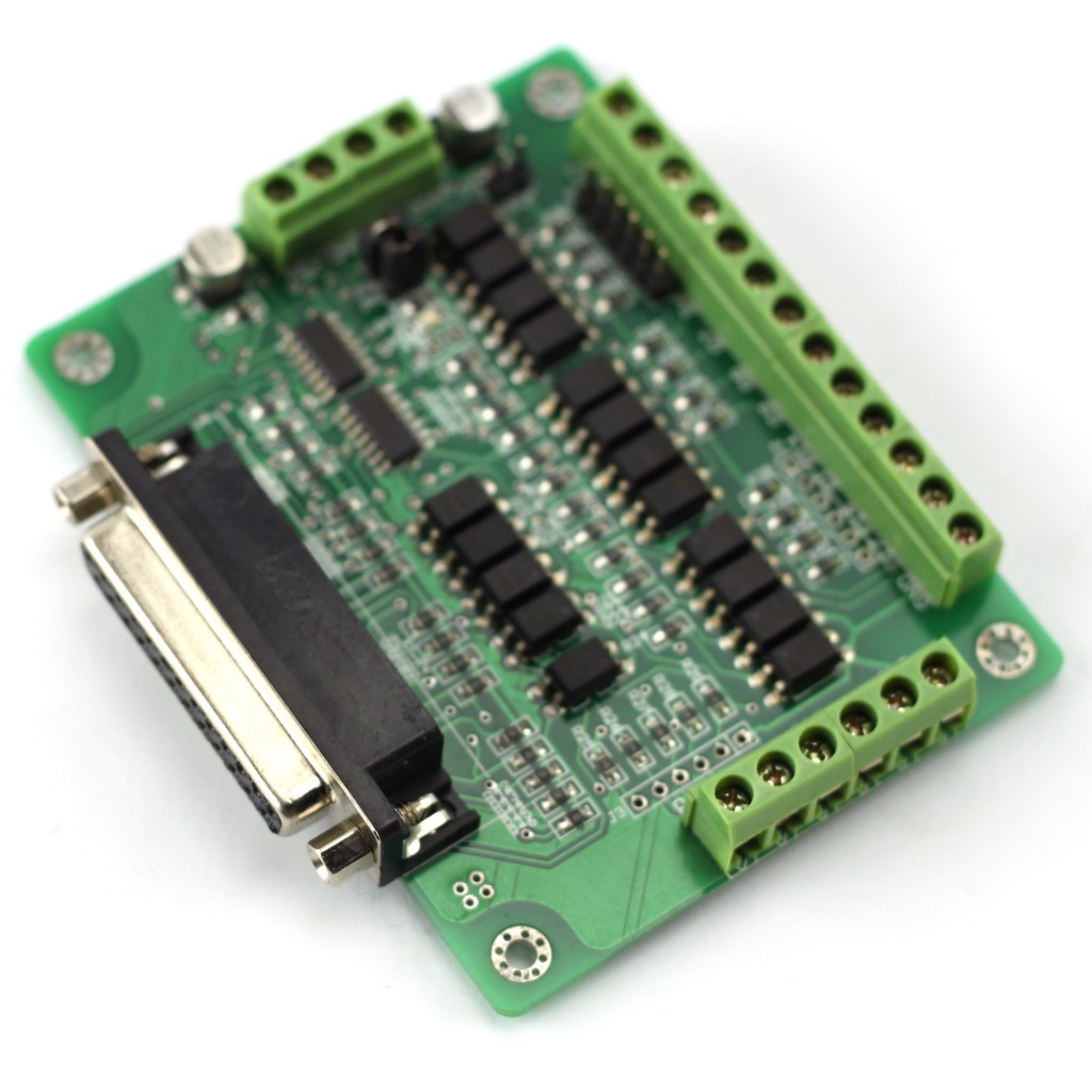

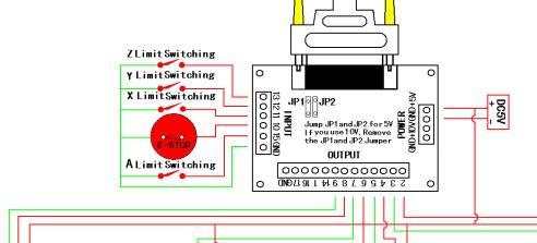

Ger and Ken, on the diagnostic page the digitize LED is not lighting up when you touch the plate to the bit. I don't know why it stopped working. I even soldered a new 2 pin GX 16 connector and put it in to the controller. I just got a UC400 ethernet
controller and run a basic DB25 breakout board to it. It is wired just like the diagram shows. The E-stop is a 2 pin connection and is wired the same way. The led light does light up on the diagnostics page when I activate it.
gills
Posts: 66
Joined: Fri Mar 25, 2022 7:42 pm
Re: MAch 3 touchplate script error
Postby ger21 » Sat May 31, 2025 12:03 pm
You might not have any conductivity through the spindle.
It's not going to work until the LED lights up, every time you touch it.
