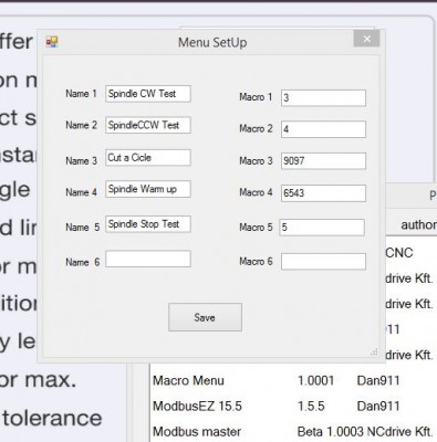

I started writing this menu plugin before I decided just to put all wizards into 1 plugin. It needs a button created on screen with # 44444. I can make it be able to be called with a macro/mdi if any 1 needs or prefers it.

Thanks Terry and yes, can be called via a hotkey. Probably failed to mention because not a big fan of hotkeys, especially of windows that may need to be opened and closed often. I know your preference is the opposite.

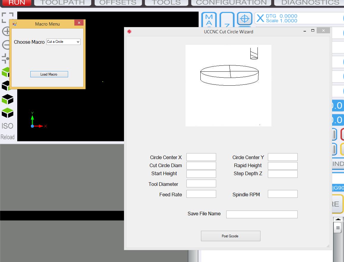

Now I have one small button on screen to open the macro menu and all macros/plugins to call by name with a click. I find it a pain to remember different key combinations and macro numbers. I see I'm going to have to increase the amount of items in the comboBox.

The QuickCam Wizard CANNOT be open with a macro and needs a on screen button to work, if called with a M code you will get a [STATHREAD]
exemption when you try to open a wizard. I posted this on the download page. It is opening a form within a form and cannot be handled in plugin unless I change the interface that I like.

Hi Dezsoe,
I tried your suggested solution and many others with no success, I'm not convinced it is a Directory issue. QuickCam works fine with a created button or hotkey(GUI) but when opened with the CallButton()
inside UCCNC macro class it will only allow the first 2 Forms created to open regardless of order and will get the STAthread exemption on the other 3 when tried to open.
I did find a solution to open it with a M code, I added a informsplugin event to plugin and call button event there. I used exec.informsplugin to call from macro and all works like it should.
Ultimately I would prefer to use informplugin(Quickcam, button#) and not write to all plugins but can't get around that function needing a return. Any idea's?
