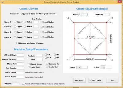

Hello All,
I was notified of bugs/errors in Wizard V1, all in the Create Square Rectangle Cut/Pocket Wizard. Sorry but fairly confident most are fixed now, at least any serious issues. What was fixed can be read below.
1. When Folder was created it wasn't always in the UCCNC folder...............Fixed
2. Clockwise cut or Pocket wasn't working in Square/Rectangle................Fixed
3. Overlooked variable caused square or rectangle size to double..............Fixed
4. Due to above problem caused issues with pocketing.........................Fixed
5. Tool compensation didn't update................................................Fixed
6.Wouldn't call this a bug but if clipped corner or radius corner value was larger than width or length you got some unexpected results....Fixed
WizardsV2.zip

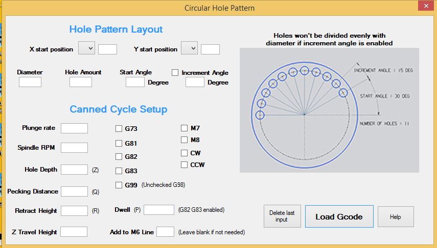

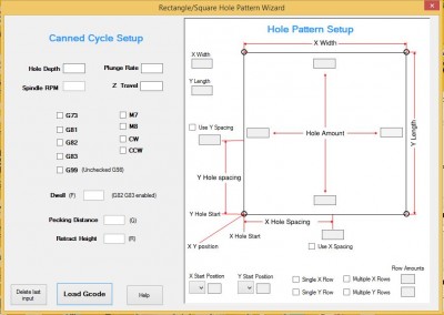

Hi Everyone,
I finished up another "Wizard Rectangle/Square Hole Pattern" and will be testing the next few days, so if anyone wants to help in testing please PM me email. I also configured Wizard V3 that can be called via MDI, or you can configure a hotkey besides just creating a button. I also added a help button with instructions to help get you started.

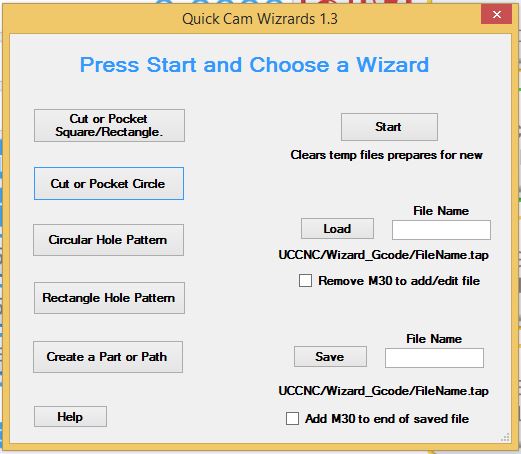

Hello All, I want to apologize to all who PM'ed me for testing and I didn't reply. I wasn't happy with work flow when using and continually found bugs and was limited to what I was trying to achieve when using so thought it useless to send/post with bugs and limitations I already knew was there...list got long. hoping others who may find use can help. Added many new feature such as adding to any Gcode file and using multiple wizards to same file. I added help files to most wizards but not complete yet, not that steep of a learning curve to figure out.
Once 100% convinced plugin is generating safe Gcode I will post in Tool or Plugin section in forum. Be aware downloading here is for testing purpose's only.

Here you go. To use you need to create a button with screen edit and give it a button # 6333. You can also set it up with macro using MDI or hotkey.
WizardsV1.3.zip
Thanks again.
