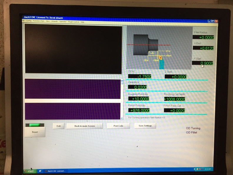

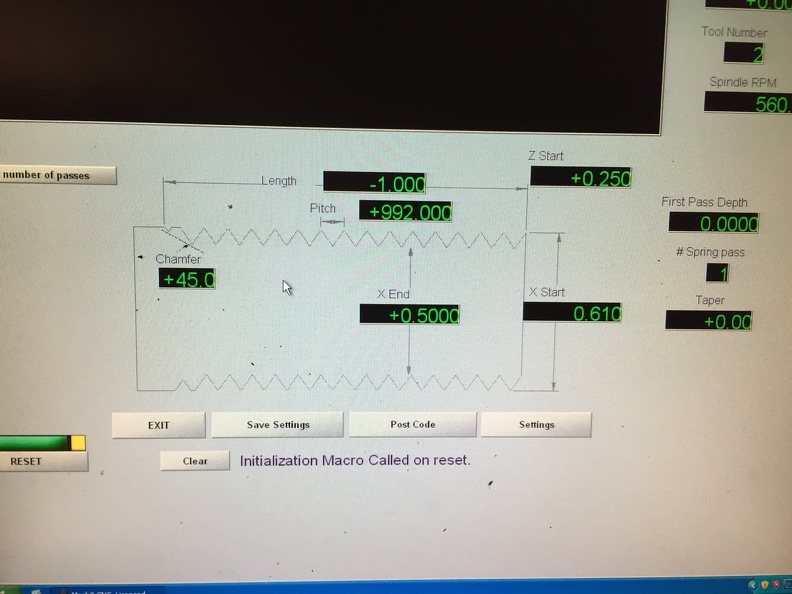

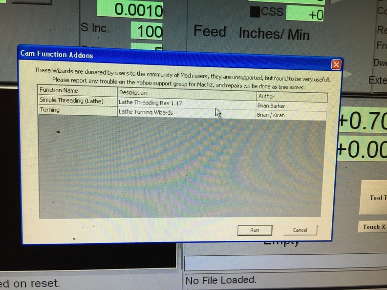

FYI the UC-300 plugin breaks some of the input DROs in the built in turn wizards. They must share the same numbers or something. I never bothered to report it since I was hoping on getting UCCNC lathe to work and then I just ended up going back to Mach and the PP. Ultimately I wanted the UCCNC for encoder feedback threading.
Here are some screen shots.
These are the wizards.
Rouging Depth DRO is stuck at 1008
Simple threading pitch DRO same problem.
There may be others but I quit trying and rolled back to the PP.

Re: CNC Lathe Info
Postby cncdrive » Sat Nov 04, 2017 12:25 am
It is probably bugs in Mach3, because as far as I know plugins generally do not have access to DROs on wizards like this.
I can ask my collegue to look after it, but I'm not optimistic that it could be resolved, because it does not look like a plugin related issue, but something to do with Mach3 handling things incorrectly when motion controller plugin is loaded (I mean I'm assuming this if this thing works OK with PP). But we have no oversight of the source code of Mach3, so we can only guess about what is happening with the wizard...

Postby ger21 » Sat Nov 04, 2017 2:30 am
You can easily change the DRO numbers in a screen editor, and edit the VB code using Operator > Edit Button Script, and clicking the Post Code button.
I don't have my UC300ETH connected, but I have the UC300ETH plugin installed, and I don't see what you are seeing when I just tried the wizard.
Posts: 2789
