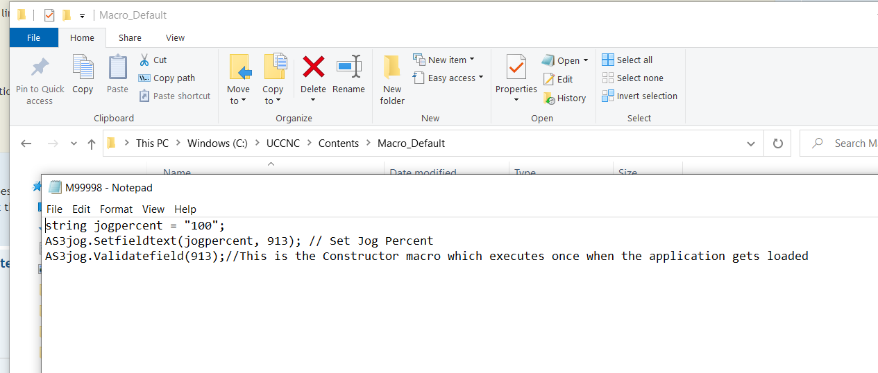

What am I doing wrong here? screenshot attached. Thank you

Postby reshleman » Sat Nov 18, 2023 11:15 pm
I had this in the wrong macro folder. It’s working now.
