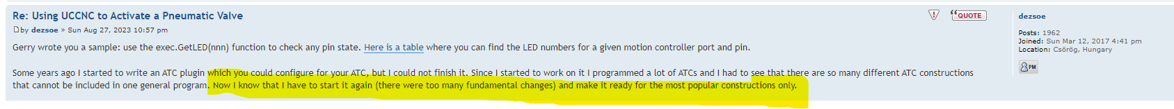

Sorry Mark (and TomahawkCNC), but I spent the most of the time yesterday with a reported bug. Your impossible request went down the queue. It's impossible, because I have only a concept how to modify the screenset (and I have it only for the Default2019). As I wrote in the quoted post I don't have a turnkey solution, but I can generate screensets for specified number of tool slots. More details later in mail, hopefully today.
The concept is to show the rack positions on the main page (green is the loaded tool):
And a more detailed page to load the rack (which is a bit obsolete, because it doesn't have the X offset):
