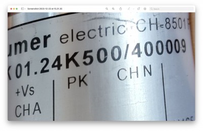

Postby DaveKerr175 » Sat Dec 23, 2023 3:29 pm
here is the table where it shows which pules per rev it is according to the part number. 2048 is the max PPR this model is available in from what I understand of it?
Here shows my part number
I got to 2000 because I thought it was considered quadrature and needed to be multiplied by 4 but I'm not sure I understand the meaning of this fully
thanks for the help...
