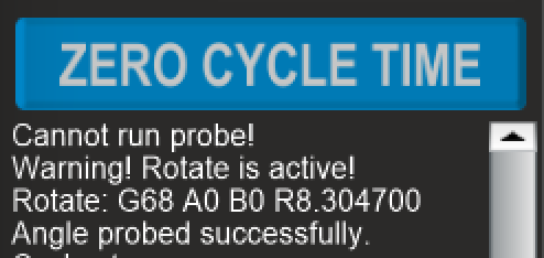

I was wondering if anybody managed to use this successfully? I cannot understand the sequence that is supposed to be used. I tried;
1- I used a 3D probe to successfully measure the angle.
2- I loaded Deszoe's macro to successfully rotate the coordinate system getting the angle from the probe screen.
3- I loaded the g-code file and the toolpaths appeared rotated in the viewer. So far so good.
4- Then the machine requests the new tool to go to measure the length and start cutting.
5- It goes to the probe and stops with a "warning! Rotate is active!" and refuses to react to the probe button.
I cannot do it in reverse order as every time that you probe a tool the angle in the probe screen disappears.
