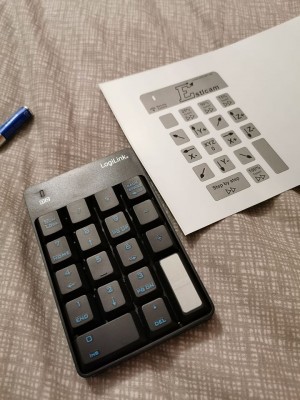

I want to ask you if there is a way that the numpad is working in UCCNC also. I have it from Estlcam and would like to use the same keys also in UCCNC.
Single Axis Movement went fine by set it at the hotkey menu. But 2 axis by press 1,3,7 or 9 and the other functions will work only with macro, sure? (see pic)
Does anyone give me a little help for programming, I am new in uccnc especially in Scripting :(
Greets Markus

2 axis will work only if you press the 2 arrows together. There's no key function to move 2 axis together. You can use those buttons to do other things: PgUp and PgDn is Z + and - by default. You can change these in the Settings / I/O triggers / Hotkeys.

I don't use hot keys, so this is as much a question as a suggestion, but can you assign the same key twice in hot keys? IE, in one row, assign #1 key to activate the -x jog and in another row also assign #1 key again to activate the -y jog at the same time? You'll also need to assign xjog off and yjog off when keypress stops.
I know from in macros/plugins you can activate both -x jog and -y jog buttons simultaneously to get a diagonal move.

Yeah, I'd do a hotkey that calls a macro to run x jog and y jog at the same time.
I went a slightly different route with my pendant. Arduino based with Bluetooth. Still just a glorified keyboard but the arduino gives me flexibility to do things like offset, step and jog %.

since Dezsoe verified you can easily set the diagonal jogging in hot keys by assigning 2 buttons to one hotkey, I'd go that route for simplicity over having 4 additional macros to push the buttons :).
To do the velocity changing in a macro, you'll set a velocity percent value into field # 913. Copy this into a macro and run:
//M20099 Sample velocity % changer
double velocity = 50; // enter desired % velocity here
AS3jog.Setfield(velocity, 913); // set velocity
AS3jog.Validatefield(913); //validate velocity input
if(!exec.Ismacrostopped())
MessageBox.Show("Velocity set!");  // comment this out after verifies it works
else
exec.StopWithDeccel();
MessageBox.Show("?? what happened!"); // error for some reason
I believe trying to pickup up a keypress directly from a macro is somewhat difficult, so if you want 4 speeds, save the above as 4 different macros and assign each to a hotkey as the easiest way.
