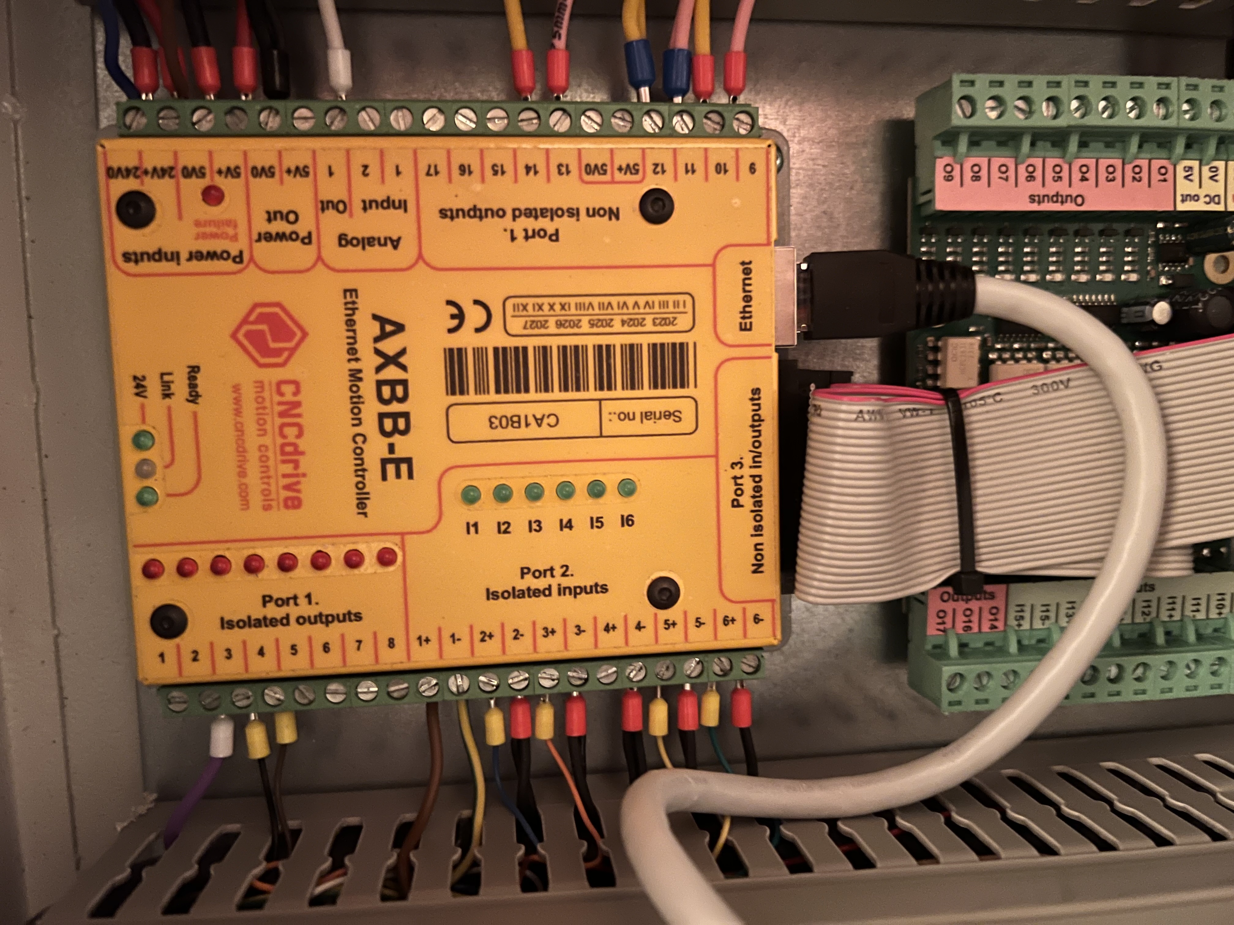

Hi everyone,
I’m currently setting up a 4-wire normally closed fixed probe on my CNC machine, and I’m using the AXBB-E motion controller with UCCNC.
The probe has the following wires: yellow, green, red, and black. I’d really appreciate it if someone could kindly explain how and where to connect each wire to the AXBB-E controller.
Thanks in advance for your help!

Postby cncdrive » Sun May 25, 2025 4:21 pm
This probe requires 2 signals to operate. There is an output circuit diagram on the e-bay page.
One output is the probe signal and the other is an overtravel protection signal.
Connect each signal to 1-1 inputs on the AXBB-E controller.
Configure the probe output as probe signal and configure the other signal in the I/O triggers or in the Faults plugin are sStop or Reset signal.

Thanks for the reply,
Does a ground from the controller need to be connected along with the probe wire at the I- terminal?
Thanks again for your help!
