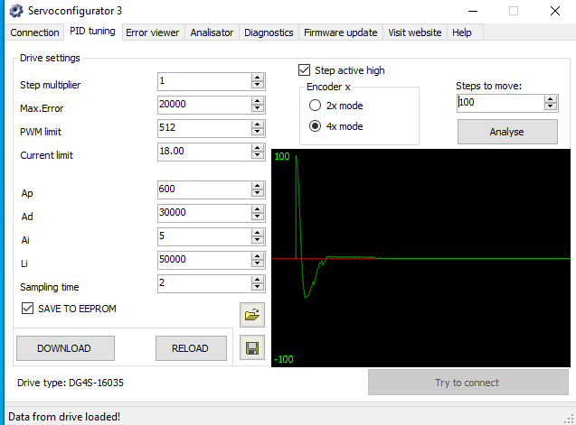

The PID has a long tail with a 1 step error (+1 / -1) that I'm not able to remove. If I keep the Ap low (as in the picture) the motor do not react to the oscillation (no noise) and every think seems to work fine
If no step are commanded the 1 step noise continues (I see it on the error monitor), but the error counter do not increase, so no reset is triggered.
If I command movement (-300 steps), like in the picture, after 4/5 times a run the test the controller resets (if I increase max error for example 20.000, the reset occurs after 10/15 times).
The picure attached is the one that triggers the error, but I cannot see a 2000 step error nowhere (no spikes, no offset)
Can some one explain me how the error mechanism that triggers the reset is working?
In the X axis, that is working fine, there is NO oscillation on the tail and the controller does not reset, so I think the porblem is the oscillation, but I don't understand why...

The oscillation at the end of the pulse (servoconfig3 step) was caused by the windup of I, so lowering the value around 2000 solved the problem.
Now X, Y, Z run smooth with pratically no overshot.
