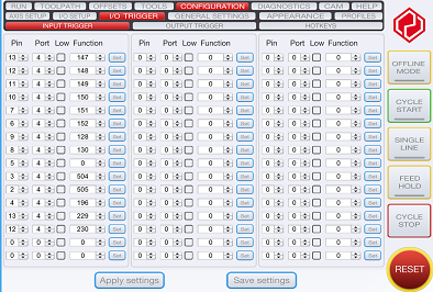

Postby camivic » Fri Dec 09, 2016 1:48 pm
Thanks for your reply,
i've tried your tips, but nothing is happen.
I also try to flag low the pin.
Attached you can found my configuration (only the x axe)

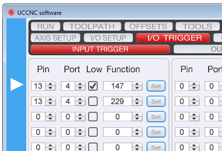

Postby cncdrive » Fri Dec 09, 2016 2:01 pm
I've tested it quickly with a UC300ETH-5LPT with one pin, one of which I see you using in your setup, Port#4 Pin#13, with the pin pulled to GND with pushbutton.
Please see the attached settings. It works fine here. The jog starts when I push the button and stops when release the button.
Posts: 5158
Re: External control.
Postby camivic » Fri Dec 09, 2016 5:31 pm
Great, now all it works.
