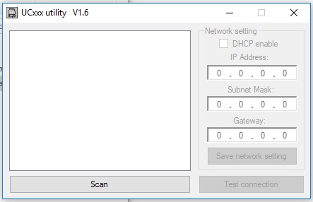

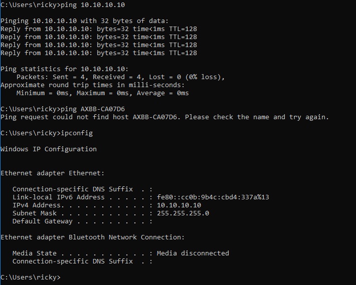

Hi, I'm not having much luck at connecting to the network! I've followed all the instructions for the AXBB-E i.e.
ip address 10.10.10.10
subnet mask 255.255.255.0
when I ping from the cmd prompt I get a valid return, but when I use the util tool, it doesn't detect the AXBB-E although the blue led light does flicker once on as I run the util
help please?
I haven't connected the 24v supply, just the 5v
also, I haven't received an email with the passkey from Cncdrive yet. could this be the problem?
I can't see why the hardware wouldn't work without Uccnc running?
thanks

Postby skrap » Tue Jun 18, 2019 2:55 am
Pinging 10.10.10.10 just shows that the ethernet adapter is setup correctly as the computer is just pinging itself.
Are you using either a crossover cable or switch/router?

Postby cncdrive » Tue Jun 18, 2019 5:59 am
You need the latest UCCNC development release for the AXBB-E controller.
From the pictures you uploaded I can tell that you using an older version which will not work with the AXBB-E.
The direct download link: http://www.cncdrive.com/UCCNC/get_devUCCNC.php
And you pinging the network adapter (10.10.10.10.), the IP of the AXBB-E is 10.10.10.11. by default.
The blue LED flashes once when the AXBB-E receives the broadcast message from the PC which the Utility tool sends to explore the devices.
