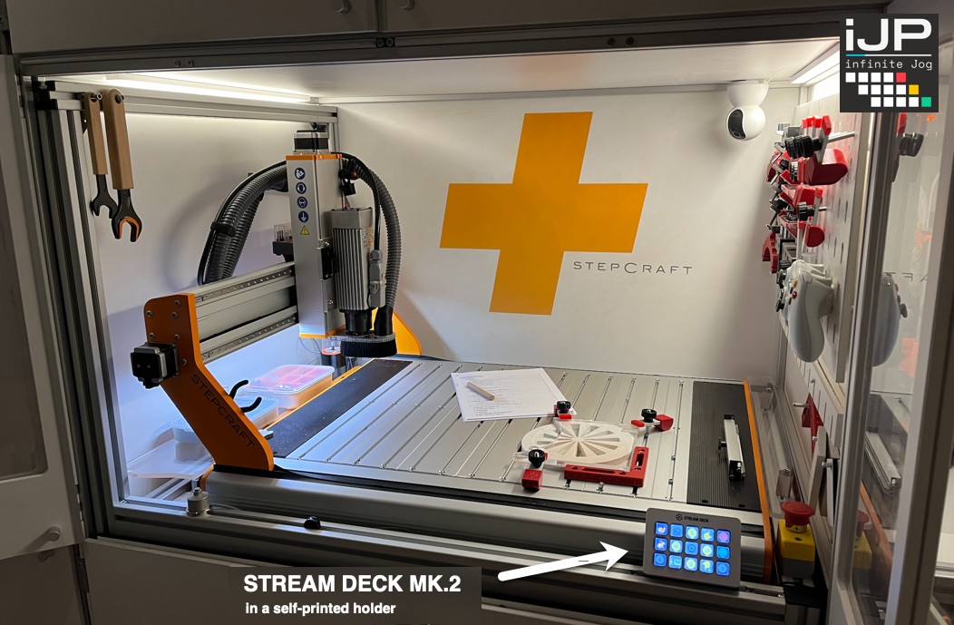

I have tested various jog pendants, keyboards, game controllers and can work fastest with the STREAM DECK MK.2, am flexible and always have one hand free.
The StreamDeck is dustproof, splash-proof and flexible like a handwheel jog pendant. I was impressed by the endless possibilities and the easy installation. There are enough hotkeys available to use some pages of the Steamdeck. I have covered the most important ones and have been working with them for 2 months.
I'm still looking for people who would like to test the interface and contribute improvements ... If you are interested, write a comment, describe your suggestion for improvement or your concerns and criticism.
What do you think about the infinite Jog Pendant?
infinite Jog Pendant in in a self-printed holder

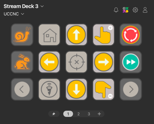

Drive Page 1

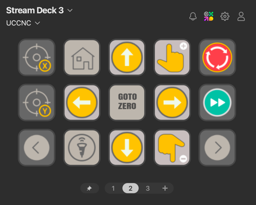

Setup Page 2

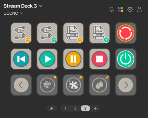

Job Page 3

I saw your post and the 3 screens, one of the very important screens for me and i think for many is a dedicated probe screen with main options and a optional screen to put macros.
Thanks for this i will folow further developments and could test thank you
