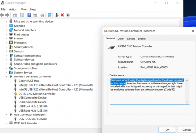

If I look at the drivers, it shows the unsigned issue mentioned elsewhere on this forum. I've tried all the steps from viewtopic.php?f=4&t=3732, in other words uninstalling the drivers, disconnecting, turning off network connectivity, re-inserting and installing the drivers again but exactly the same result occurs. The last page postings there mention that the latest windows update fixes everything but I'm fully up to date windows 11 as of 15/08/2022.

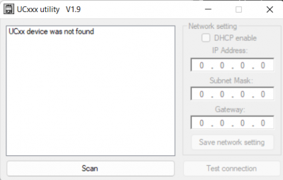

Previously I was trying the drivers from http://cncdrive.com/MC/UC100%20files%20 ... rivers.zip but I have also just tried the drivers from the setup_1.2115.exe - see the attached screenshots.
Regarding elevated windows permissions, the installer of UCCNC requests them but from device manager I don't get a prompt for elevated perms when updating the driver. Also I don't see an option to open the device manager as admin through the normal right click mechanism.
I'll give the drivers from 1.2113 a go but it feels like a bit of a longshot.

Postby dezsoe » Thu Aug 18, 2022 11:27 am
The drivers in 1.2115 will not (always) work. MS made some updates/changes in the last 1-2 years and we tried to follow them. Any time we updated the drivers MS made a new twist. Now we have 3 versions of the drivers and MS returned to the original requirements, so with a fully updated Windows the old drivers work. Also, you don't need those super fancy tricks to install the driver: just disconnect the Internet, remove the driver with selecting remove driver files. Disconnect and reconnect the UCxxx controller, select the unknown device and install driver from the 1.2113 directory (and subdirectories).
