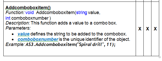

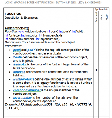

Below is an extract of all plugin functions
Can I suggest firstly that maybe cncDrive consider standard nomenclature for some of the parameter names.....
such as the following examples:
void Addbutton(bool isAS3, double x, double y, double w, double h, bool toggletype, bool blinktype, int picturenumber, int buttonnumber, int layernumber)
void AddUCCAM(bool isAS3, int fillcolor, int posX, int posY, int sizeX, int sizeY, int labelnumber, int layernumber)
would it be possible to go through the function descriptions within uccnc as a houskeeping task and just change some of the desicriptions to standard ones please?
(once done, never need to be done again, and as you're only editing the descriptions there should be no change of bugs to to the change)
Note: these are the plugin functions..... not all will work with macros and screensets, and some of the macro functions are also not plugin functions, such as:

Although I've not tested the theory..... if the function has "bool isAS3" as a parameter it should be able to be used within screensets.... such as : void Addbackground(bool isAS3, and Addcheckbox(bool isAS3
void Addbackground(bool isAS3, double x, double y, double w, double h, int picturenumber, int backgroundnumber, int layernumber)
void Addcheckbox(bool isAS3, string labeltext, string labelfont, int fontsize, int fontcolor, int posX, int posY, int boxnumber, int layernumber)
void Addcodeview(bool isAS3, string labeltext, string labelfont, string textalign, int fontsize, int fontcolor, int posX, int posY, int Width, int Height, int layernumber)
void Addcolorpick(bool isAS3, double x, double y, double w, double h, int LEDnumber, int layernumber)
void Addcombobox(bool isAS3, int posX, int posY, int Width, int fontsize, int fontcolor, int Numberofaxis, int labelnumber, int layernumber)
void Addcomboboxitem(bool isAS3, string val, int labelnumber)

Re: Macro_capability_detailed.htm - suggested corrections
Postby Robertspark » Sat Oct 22, 2016 9:47 am
Well I've been stuck with a dilemma regarding functions and the manual I created....
Some functions can be used with screensets, some with macros and some only with plugins, and there is a combination of all three possibilities in some cases....
I didn't want to bload the manual by listing functions in three sections if they could be used with the other two, hence I've come up with the following table arrangement with a cross indicating the functions compatibility....
comments on a postcard, what do you think? (The manual should be there to help you afterall, if it's not user friendly / could be better then it's best to set it out early what you think may be useful [or not]).
