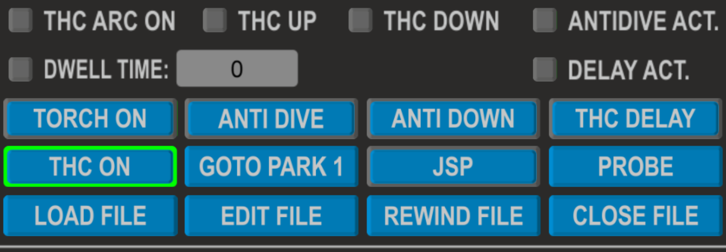

Postby Pyruu » Sat Jun 20, 2020 6:47 pm
had to do some similar stuff again.
I made a video for better understanding
below is the g-code from the video
https://streamable.com/8sazg8
Is this problem related to my g-code?
from line N0870 the arc ok is working.
thanks in advance

Postby laki » Sat Jun 20, 2020 7:26 pm
The video shows that THC delay is on.
The value for THC delay is 1s.
Turn off the THC delay and try.

Postby Pyruu » Mon Jun 22, 2020 4:56 am
No difference.
I thought thc delay executes after M3 detects an arc ok signal.
Thc delay blocks only up/down motion.

Regarding the video there seems to be some really weird stuff going on. Example, lines:
N870 M3 ARC OK LED DOES NOT TURN ON
N880 G04 P2.4 ARC OK LED STILL DOES NOT TURN ON
N890 G01 Z4.0000 F2970.0 THC TURNS OFF AT END OF N880 G04 P2.4
Before doing anything else I'd look into these issues. Something is not right.
