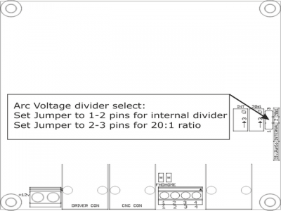

First - check position of the divider selection jumper on the controller PCB. If you use 1:20 input the jumper must be set on 2-3 pins.
