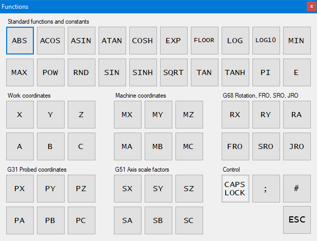

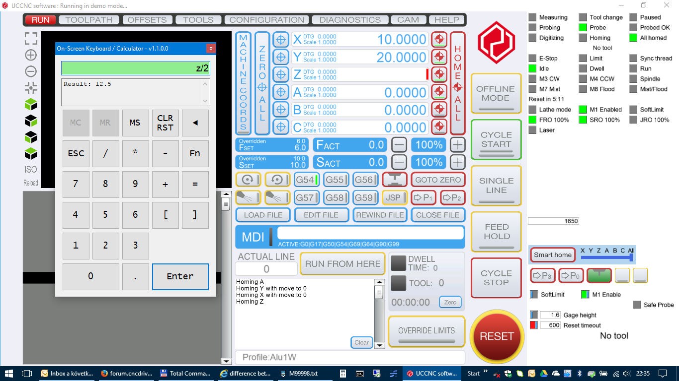

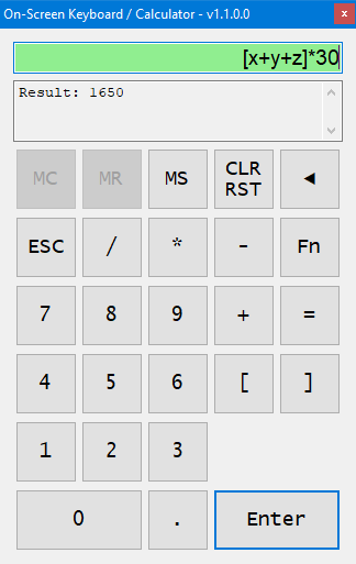

This plugin helps entering numbers into input fields. Enable the plugin (Call startup not needed), then click into any input field: you get a calculator-style on-screen keyboard, and it is really a calculator. You can do the following:
    * type any numbers
    * use g-code functions (abs[], etc.)
    * use actual #nnn variables
    * use special variables as x, y, z, etc.
    * write/read/clear memory
Check attached pictures, download, use!

The machine won't move to the new position if you enter a coordinate, so if you enter it with the help of this plugin, it still won't move. This plugin is for helping the input with on-screen keys (using only mouse or touchscreen) and, if needed, calculation and/or memory etc.
If you need some fields to set a movement, you need to program it. Put fields on the screen and write a macro which reads these fields and moves to that position.
