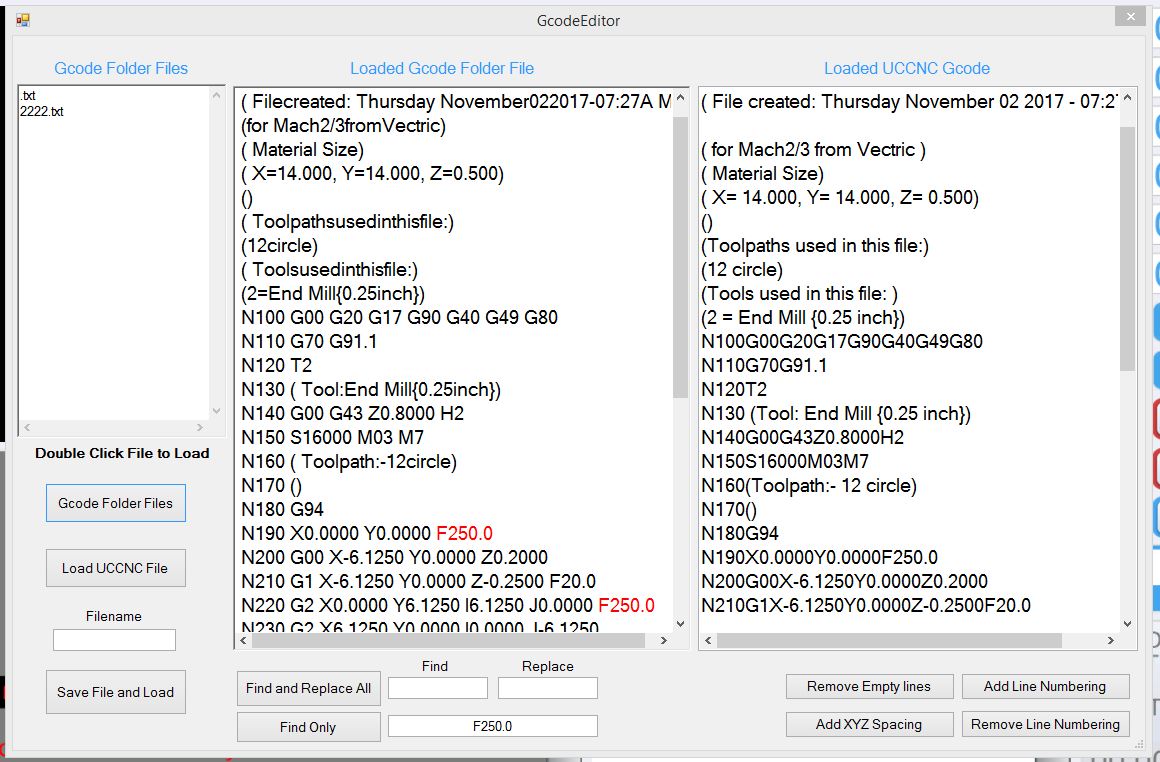

Postby Dan911 » Sun Nov 04, 2018 7:37 pm
Hi Terry,
I added a window for loaded Gcode in UCCNC so not have to deal with both open. Is this what you were asking me for? Just needs some editing bells and whistles but almost 3 hours of coding for fun is enough
for1 day.
This will add a folder to UCCNC "GcodeEditor" and this is where the plugin will look for files and save them. When you first try this folder will be empty so when you press the "Gcode Folder File" button nothing will happen until you populate it with Gcode files. It will only find .txt and .tap files. You need to have a Gcode file loaded in UCCNC or the button press will do nothing. When saved that file will be loaded in UCCNC.

Hey Terry, Needs Net 4 versions, 05 or 06, don't know why I did that, I just started to play and get involved. Per instructions if G-code file not loaded in UCCNC button press will do nothing. Created in and tested on 8.1 64 and just tested on XP 32 and no problems on this end.

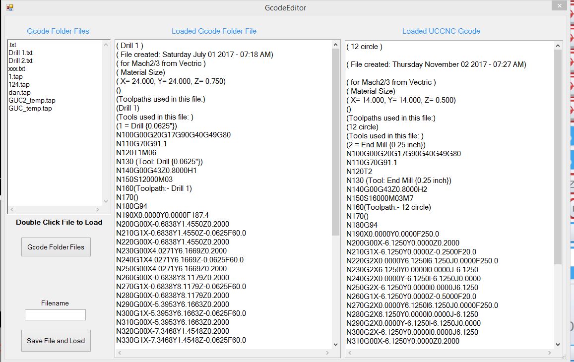

Postby Dan911 » Tue Nov 06, 2018 1:54 am
Hmmm.. Why PM/email me to do this for you if were just going to do yourself?? :? UCCNC editor works well for me!
Long work day to tired to continue, absolutely no testing and not complete.

Postby Dan911 » Tue Nov 06, 2018 10:59 pm
Thanks Terry, there's really not much to it, the hard part is getting a good work flow like you pointed out. I have all working well and what I do like most is the coping/pasting seems to work easier than the UCCNC editor. I will add in your suggestions tonight and should send. Big project at work been taking from my desk/play time. :(
