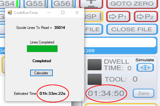

Result from CodeRuntime Plugin VS actual.
CodeRuntime gives accurate estimate.
