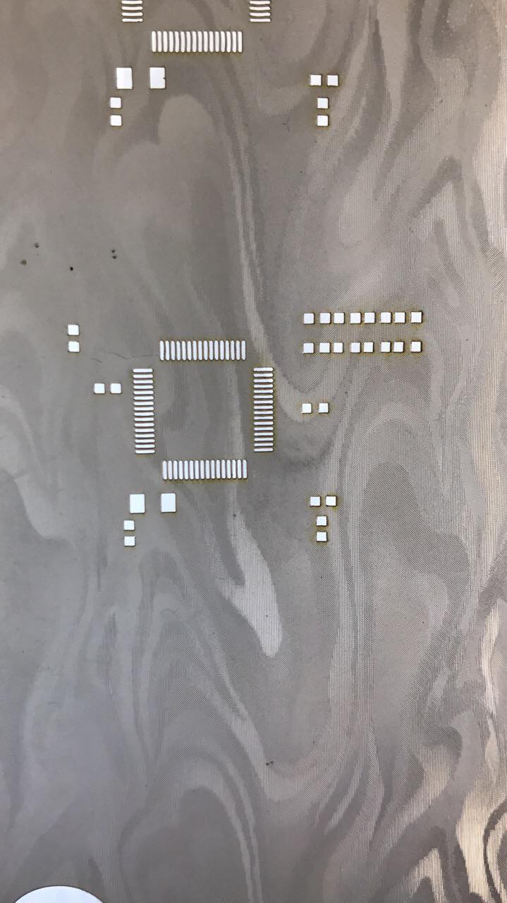

We using this laser for several things, for example for stencil foil which is in other words SMD paste masks for SMD soldering.
We doing this with g-code with the M10/M11 commands not with the laser plugin, but the laser plugin also works fine, lots of users using it successfully.
I'm sending a picture in attachment of an SMD stencil we've made.
