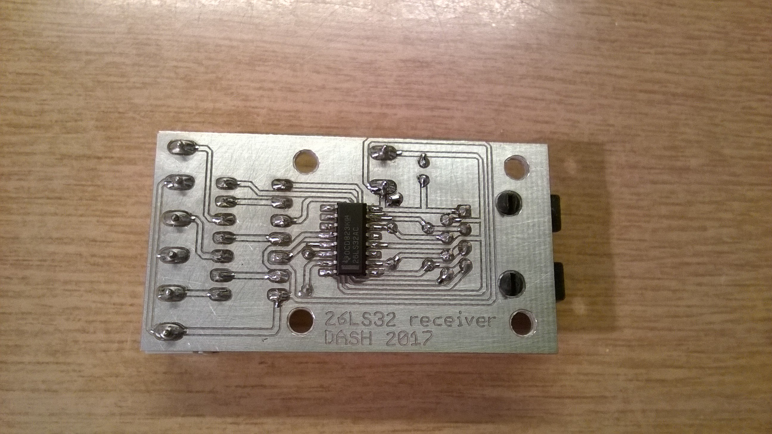

Postby dezsoe » Sun May 28, 2017 8:06 pm
I wrote about my machine, but forgot to post a photo of an SMD PCB.
