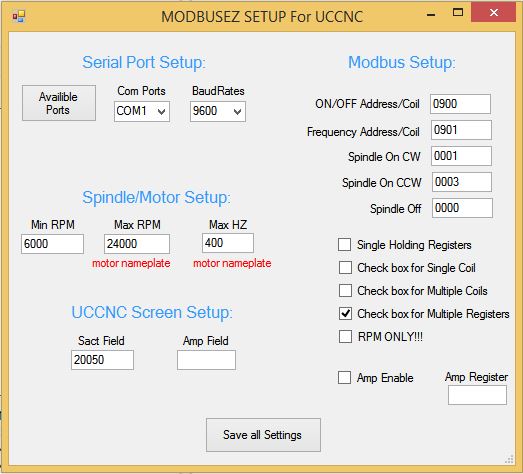

Hello Everyone,
If you have the typical China Spindle 24000rpm/400hz and a Modbus Standard VFD you my find interest with this plugin, with a $5.00 RS485 converter you can be up and running in minuets with UCCNC controlling your spindle. UCCNC provides a great Modbus plugin, but some macro writing knowledge is needed and the MODBUSEZ plugin will eliminates that and you can learn while you use.
I provide set up instructions for the commonly used VFD's and may add if requested, below is the set up for Hitachi VFD, you can check link for other available configurations and to download plugin.
http://www.cnczone.com/forums/uccnc-con ... cnc-3.html

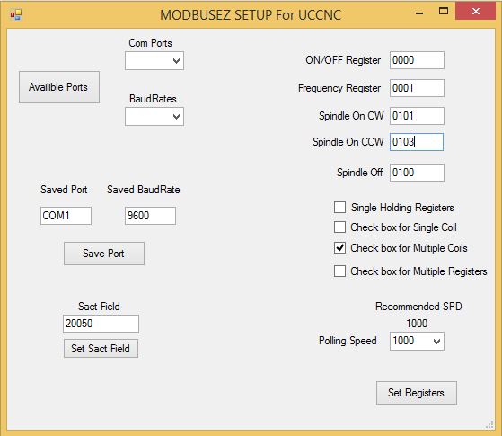

Since this plugin was built from same platform as the HYPLUGIN unfortunately bugs within that plugin followed before fixed. Regardless if any using this plugin I couldn't leave it with knowing there are problems within. Since I took the time to fix any known bugs I went ahead and updated features since it was a simple copy/paste from the HYPLUGIN. New features listed below.
ModbusEZ5:
1. When changing through UCCNC interface screens quickly could cause it to lockup....Fixed
2. Added any spindle/motor can be configured to use this plugin.
3. Implemented use of the UCCNC pulley system.
4. Added register to read amps and could be used to monitor load on spindle while cutting.
5. Added Rpm only for users that use other hardware to turn spindle on/off.
6. Removed Polling speed since all commands sent are instant and don't rely on speed of polling.
ModbusEZ5 can be downloaded follow link to post #43
http://www.cnczone.com/forums/uccnc-con ... cnc-4.html
