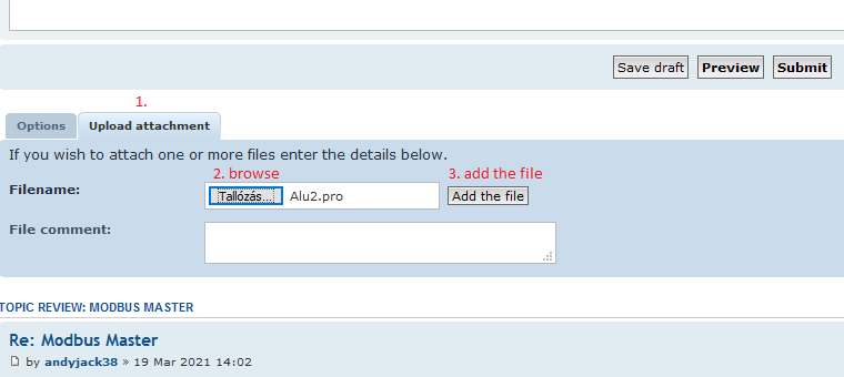

Postby dezsoe » Fri Mar 19, 2021 5:10 pm
Nothing special. Press Post reply, scroll down and press Upload attachment (1), press browse (2) to select the profile, press Add the file (3). Write some message as usual (empty message will not work). Press preview to preview or submit to submit.
