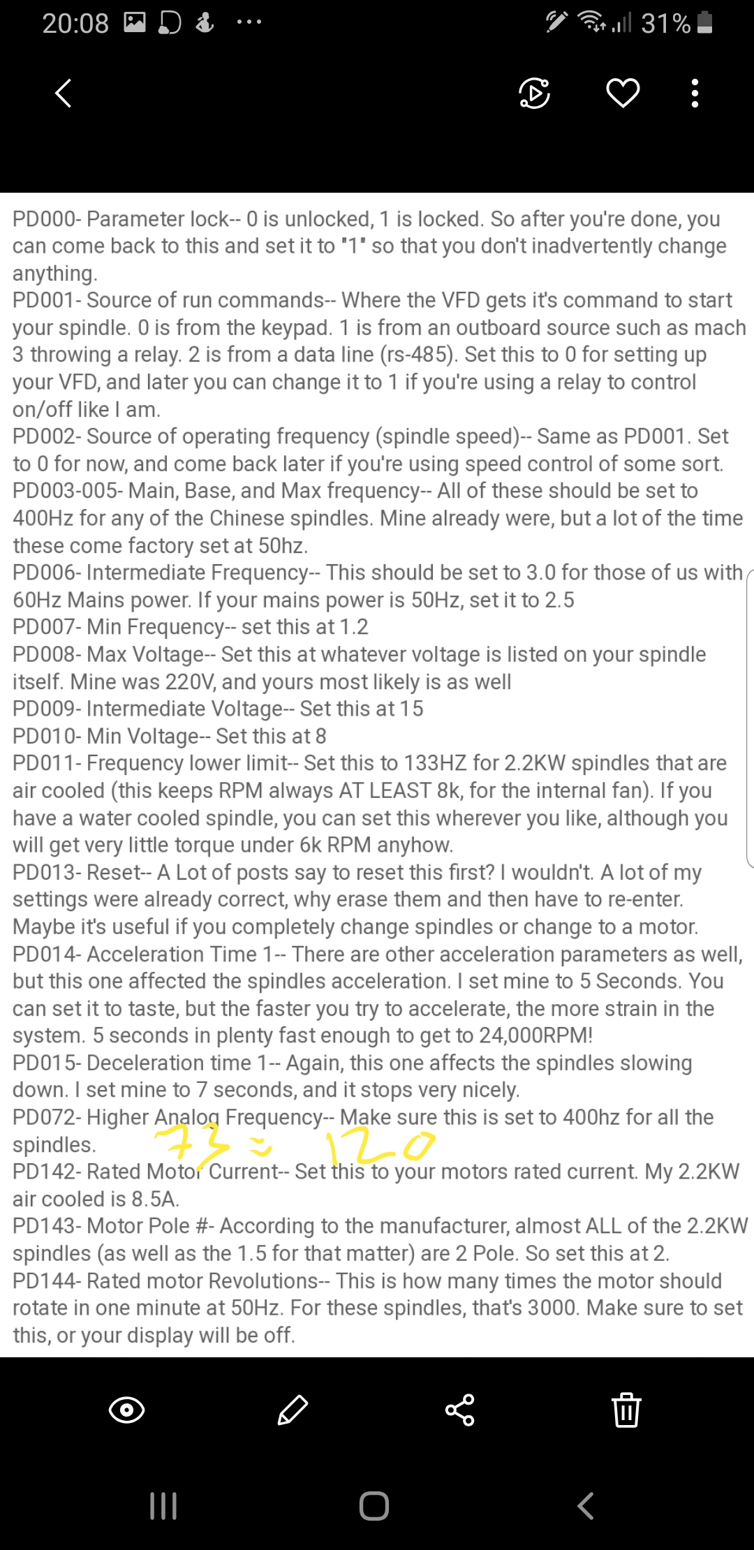

I managed to set the huayang vfd according to the settings below.
Tried the hyplugin 14 without luck, switched to v12 and it worked.

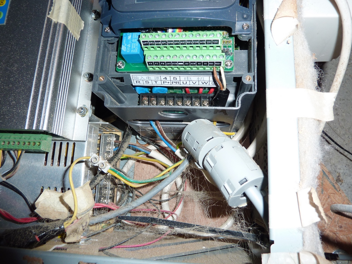

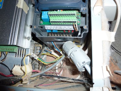

Hi all,
i agree with Ger21, it's VFD noise. I had the same problem with mach 3 when i first installed my CNC.
All was working fine until the VFD was running. I solved the problem by putting a ferrite bead (that was lying in the workshop) on the spindle cable, near the VFD.
After that, no more problems ! Cheap and efficient fixx !
As i had another one lying, i've put it near the first, just in case .... :D
Franck
ferrite bead on spindle cable near VFD
