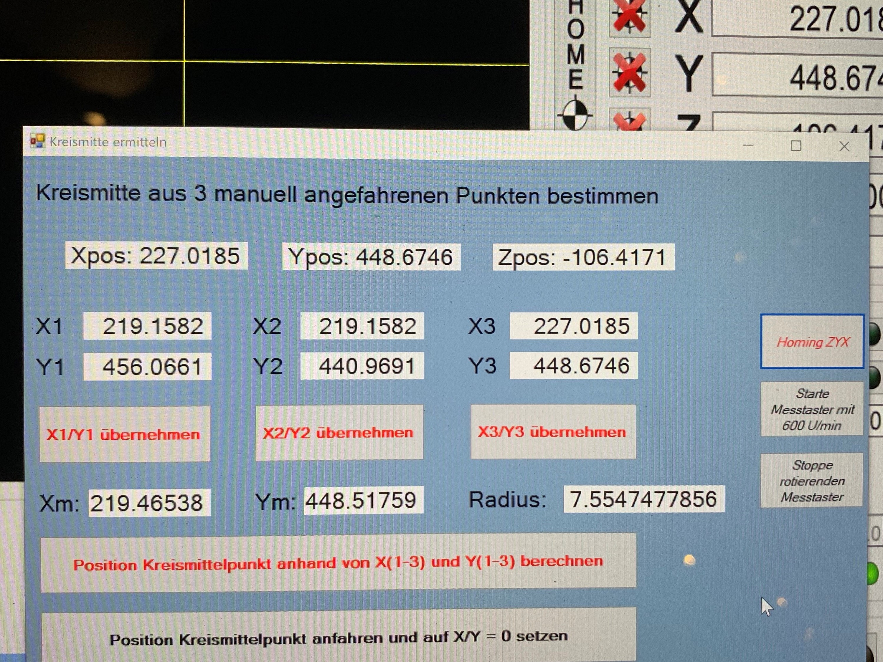

Hello,
my name is Pierre and I wrote a plugin for my manual 3D-probe from Tschorn to calculate the center of a circle. I probe 3 points and then my plugin calculates the midpoint. Then I want to run several G-Code commands in a row. But C# is too fast in processing. How can I run one command completely before the next one starts?
e.g.:
private void button7_Click(object sender, EventArgs e)
            UC.Callbutton(109); // Homing Z
            UC.Callbutton(108); // Homing Y
            UC.Callbutton(107); // Homing X
When I click on the button, it shows a strange behaviour and do random homing...
Thank you for your help.
Kindly regards,
Pierre
medicusdkfz

Here I have another problem: I want to zero the actual x-position and then also the y-position. But after moving to the wanted coordinate, it doesen't zero...
Here is my code:
if (label22.Text == "" || label18.Text == "")
            else
                UC.Code("G00 X" + label22.Text + " Y" + label8.Text); // Move to the wanted coordinate, given in the labels
                while (UC.IsMoving())
                    Application.DoEvents();
                UC.Callbutton(100); // Zero x
                UC.Callbutton(101); // Zero y
Thank you,
Pierre

Postby medicusdkfz » Sat Jan 05, 2019 7:33 am
Hello,
meanwhile there were 112 hits but still without a hint! I still have the problem that the coordinates are approached, but the zeroing doesn't work automatically. I have to start the zeroing manually. Do I need a wait cycle? How do I install it in C#? I would be very happy if someone would at least get in touch with me...
Friendly greetings,
Pierre
private void button5_Click(object sender, EventArgs e)
            else
                button5.ForeColor = System.Drawing.Color.Red;
                UC.Callbutton(109); // Safety first through Homing Z axis
                UC.Code("X" + label22.Text + " Y" + label8.Text); // Move to the calculated coordinates for the circle center
// ##################### from here on it gets faulty ######################
                UC.Wait(2000);
                UC.Setfield(true, 0, 226); // Zeroing X-Axis
                UC.Validatefield(true, 226);
                UC.Wait(2000);
                UC.Setfield(true, 0, 227); // Zeroing Y-Axis
                UC.Validatefield(true, 227);
medicusdkfz

Hello, Robert,
Thank you so much for your help. I first included "G00" and defined also the feed rate. But that's not the problem. I entered different values in the wait command and did not get any improvement.
The codesync command is not described in the manual. What does it do? My plugin is used to probe a manual 3D probe (Tschorn: https://www.tschorn-gmbh.de/en/products ... Mplus.html) in a circular pocket, in order to calculate the center point based on the 3 points and drive there. This all works very well except for the last step of zeroing. I'm a little confused why it doesn't work.
Why do I use a plugin? Because I wanted to use another possibility of UCCNC and because I can program C#. I also don't have to worry about the graphical interface as this step is made very easy for me in Visual Studio. And a Plugin is much more easier to share...
However, some routines have been revised and parameters are not well documented or not documented at all:
e.g. -> UC.Setfield(true, 0, 226); -> What do I use the bool statement for?
Thank you very much,
Pierre
