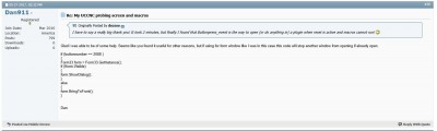

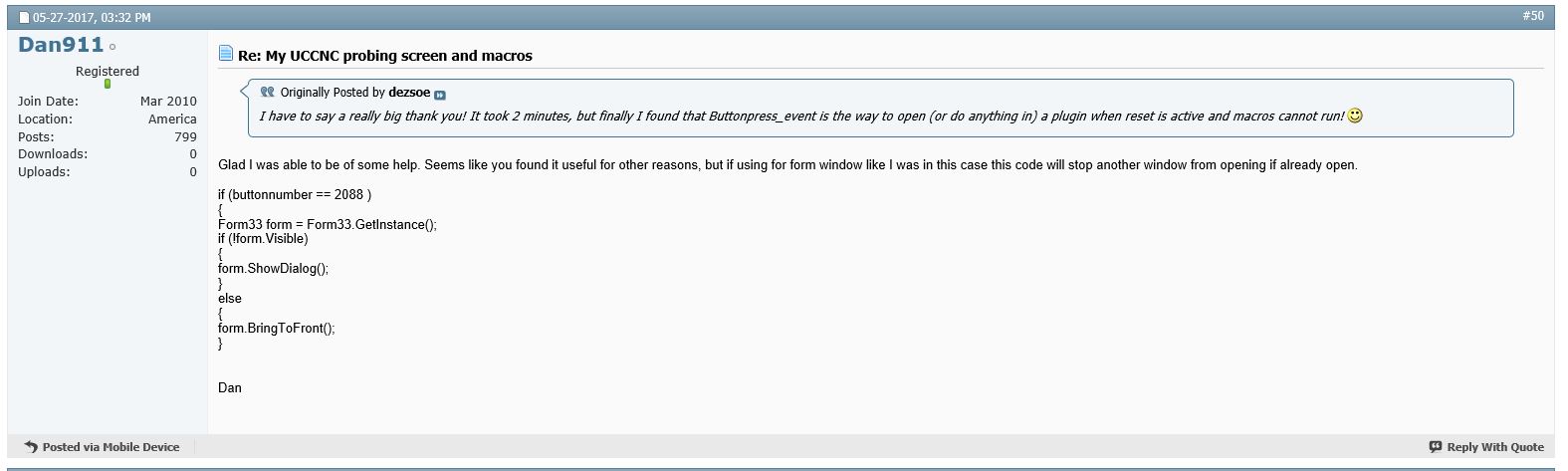

Postby Dan911 » Sun Nov 11, 2018 10:51 pm
Terry, you or anyone who wants to write plugins have to put a little more effort in to learn C# and google, I posted this on Zone over a year ago.
Why I didn't reply here is it was a lot more than not putting something in the right place.
