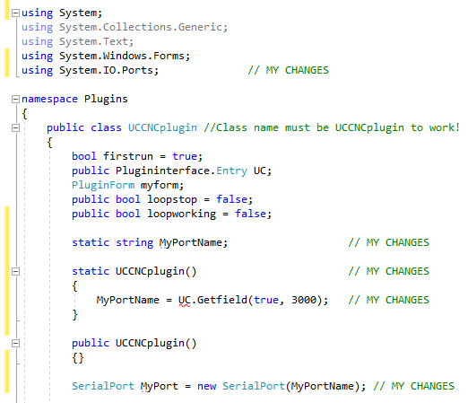

This one has been kicking my ass.
I create a new SerialPort instance easy enough. However, I want to get the port name from a DRO instead of just writing it in the plugin code like this:
SerialPort MyPort = new SerialPort("COM1");
I used the example plugin and made the changes shown in the screenshot. Wherever I added code I commented "// MY CHANGES".
As can be seen, I'm getting the red squiggly line under "UC", in the static constructor.
I used a static constructor because I read that it runs at the beginning of the class instanciation, before any class members are created, and therefore thought I could use that to get the port name from the DRO before the SerialPort object is created.
Obviously I'm doing something wrong.

Your problem is underlined on your picture. When the constructor is called, the UC variable has no value. You could read the DRO in the Init_event or in the Loop_event at the Firstrun section.

After some further Googling on the matter, it seems I was trying to call an "instance method" (UC.) from a static method (i.e. the static constructor), and this cannot be done in C#.
The error thrown was:
CS0120: An object reference is required for the nonstatic field, method, or property ............
