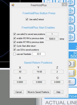

With this plugin it will change how your FeedHold button works.
When Freehold is pressed while gcode is running it will stop(), Z will retract to your safe Z setting and save the followings.
Active Models
X axis position
Y axis position
Z axis position
RPM
Feed Rate
M3 or M4 enabled
M7 or M8 enabled
When done jogging or doing whatever and want to continue with Gcode file press "Cycle Start" A window will appear showing saved settings with a yes or no buttons.
Press "Yes" and Z will go to safe Z and move to that saved position/settings press "Cycle Start" to continue with Gcode file.
Press "No" and Free Hold will continue as it normally did.

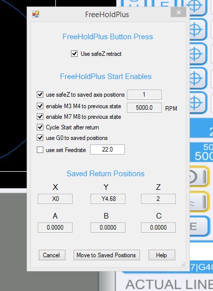

I added some features and updated plugin to work in G91, although If stopped in G91 it will start at Gcode line # it was stopped in. I also added a help button to give a brief description for each checkbox.

This is a perfect example of the old saying " If not broke don't fix it"......... Last minuet decided to save settings to profile for next use. I normally use shut down event and this time put them in the form close event. For whatever reasons unknown to me at this moment they were NOT saving to profile. Occasionally on start up I would loose my colors set in "APPEARANCE" and hotkeys settings. I narrowed down to this plugin being the cause. Trying to read settings that didn't exist would sometimes cause others to not be read/loaded. Regardless...............Fixed
Since this plugin become one of my favorites It's been getting a lot of testing. Another change made is if button is pressed and G-code file not running it will be ignored.
