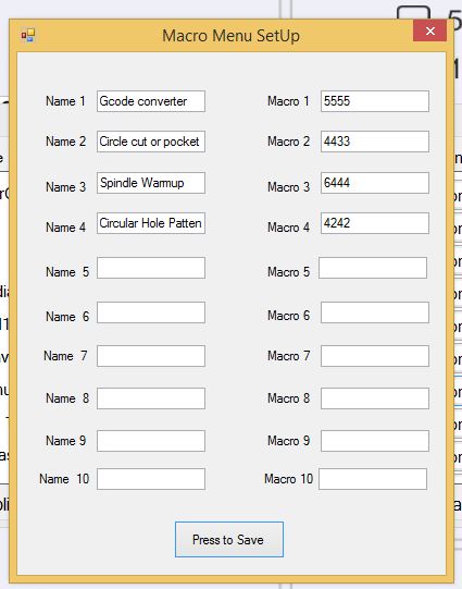

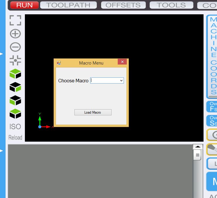

On button press or hotkey it will give you a comboBox with a list on macro's/plugin's by name to choose from and press load. You will need to go to
plugin configure and setup.
In Configure window give a name and choose macro to call.
