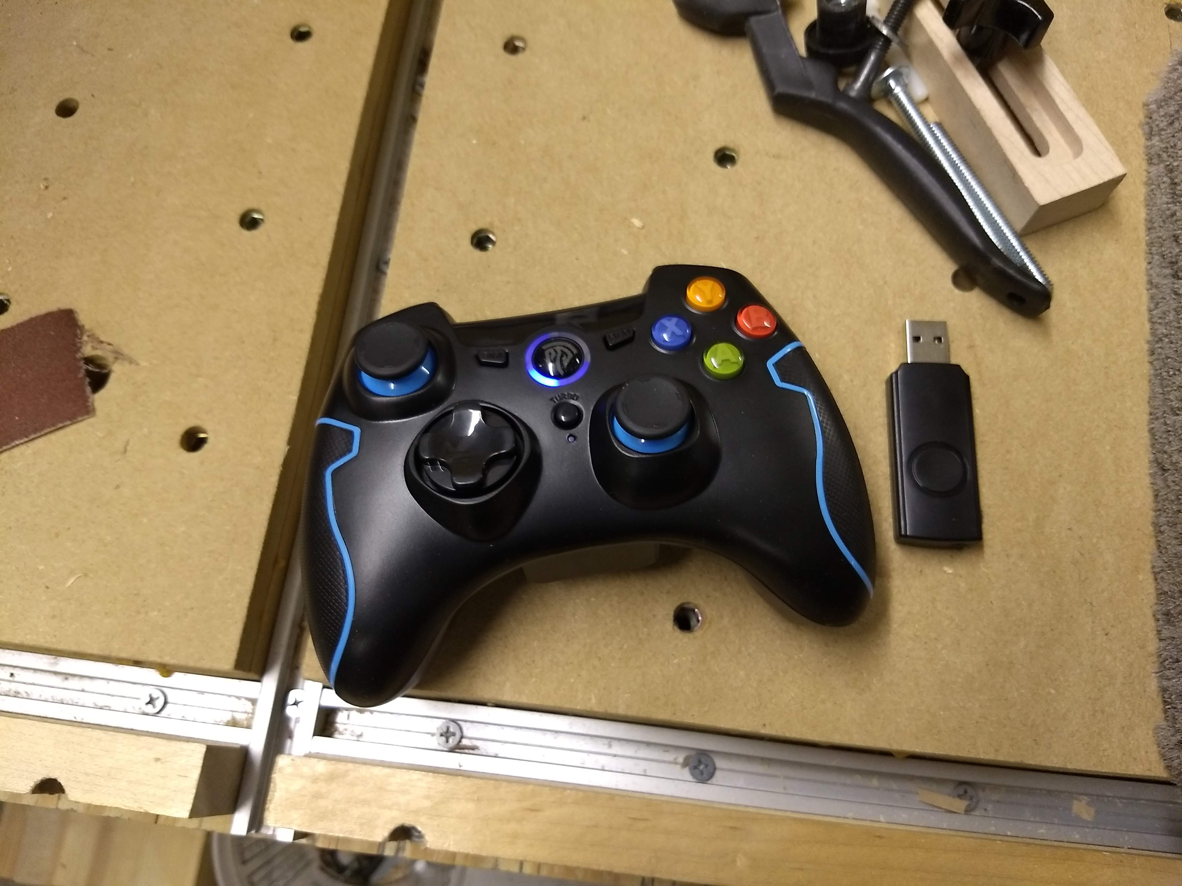

Just an FYI,
I picked up a few 'cheap' xbox knockoff controllers from Amazon to test and play with, one wired and one wireless. Both were branded 'Easy SMX'. Both work great with no problem connecting and behaving as an XBox controller. Based on playing with them, I think any controller (wired or wireless) that follows the 'XInput' standard will work fine. Testing was done w/ Windows 7 and UCCNC 2106 and the XBox plugin (v1.0010 - 5-20-18).
Other than seeming a little cheaper in material/feel, they work just as good as the real xbox controller. I picked both of these up for less than one wired actual XBox controller. Time will tell if they last... :lol:
