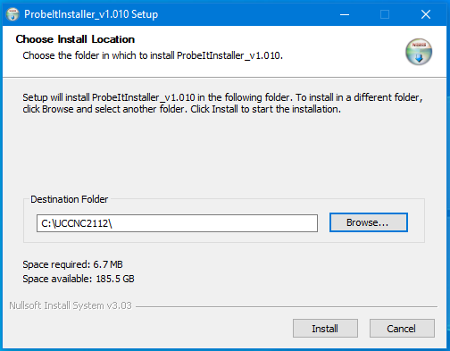

ProbeIt for UCCNC has been updated to v. 1.010 and is available for download here: http://www.craftycnc.com/probeit-for-uccnc/
Updates in v 1.010:
-Minor updates to 3D viewer, viewer now displays probe tip position real time. 3D viewer is now shared w/ UCamCopy plugin, and both plugins will receive updates at same time when viewer updates are made.
-Plugin is now provided in a self-installing zip.exe file, just point it at the uccnc folder you want to install in.
-Added ability to load ‘default’ values for inch or mm on the settings page. Please verify, change, and save settings to suit your machine. It will not overwrite your settings unless you purposefully load defaults and hit ‘save settings’ to overwrite.
-A number of bug fixes (issue w/ post routine, issues with tabs displaying properly on load)
This version has minimal additions to functionality, and is mostly bug fixes.
Installer will not overwrite your existing settings (probeit.xml) file, but I'd recommend saving a copy of your settings somewhere, or copy the entire ProbeIt folder out as a backup should you want to revert back to the prior version. When installing, point the installer to the UCCNC directory (top level), not the plugins folder:
