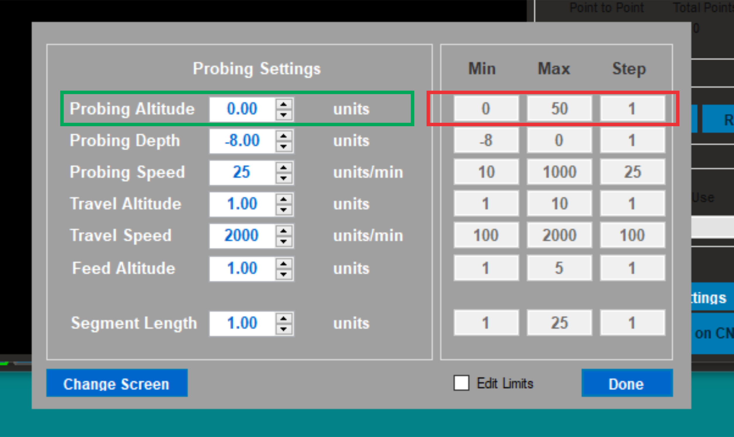

Postby cahit » Tue Mar 17, 2020 10:57 am
@Demusman
probing altitude is the height travel to first point of probing here in green color.
red color is the min max and step settings for this fields in case of using mm or inch.
probing depth is if you forget to attach the probe the tool goes max below zero.
probing speed is the speed that the tool down to pcb.
travel altitude is the travel height form point to point
travel speed is the speed between traveling from point to point.
segment length is if you have a long path across a view points that cuts the line in parts for
following the probes.
i am not sure what you do wrong.. can you make a video or i can watch with teamviewer to help you out of this problem.

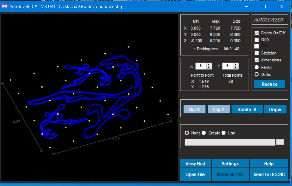

Postby 1.21gigawatts » Fri Apr 10, 2020 1:36 am
Using autolevelerCA v3.031 and UCCNC 1.2111, I have a problem. My system is in inches, so I had to modify the limits and the settings (see below) to what I thought were reasonable values. The results are, pretty well broken.
Here is the board as output from CopperCAM loaded and ready to run:
Here are the settings:
and here is a clip of the output as sent to UCCNC:
Am I doing something really wrong? Where do I go from here?

Postby cahit » Fri Apr 10, 2020 6:46 am
hi,
you are doing nothing wrong. this is a development version, it is not finished yet.
cahit
