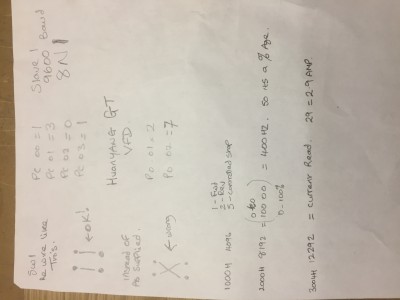

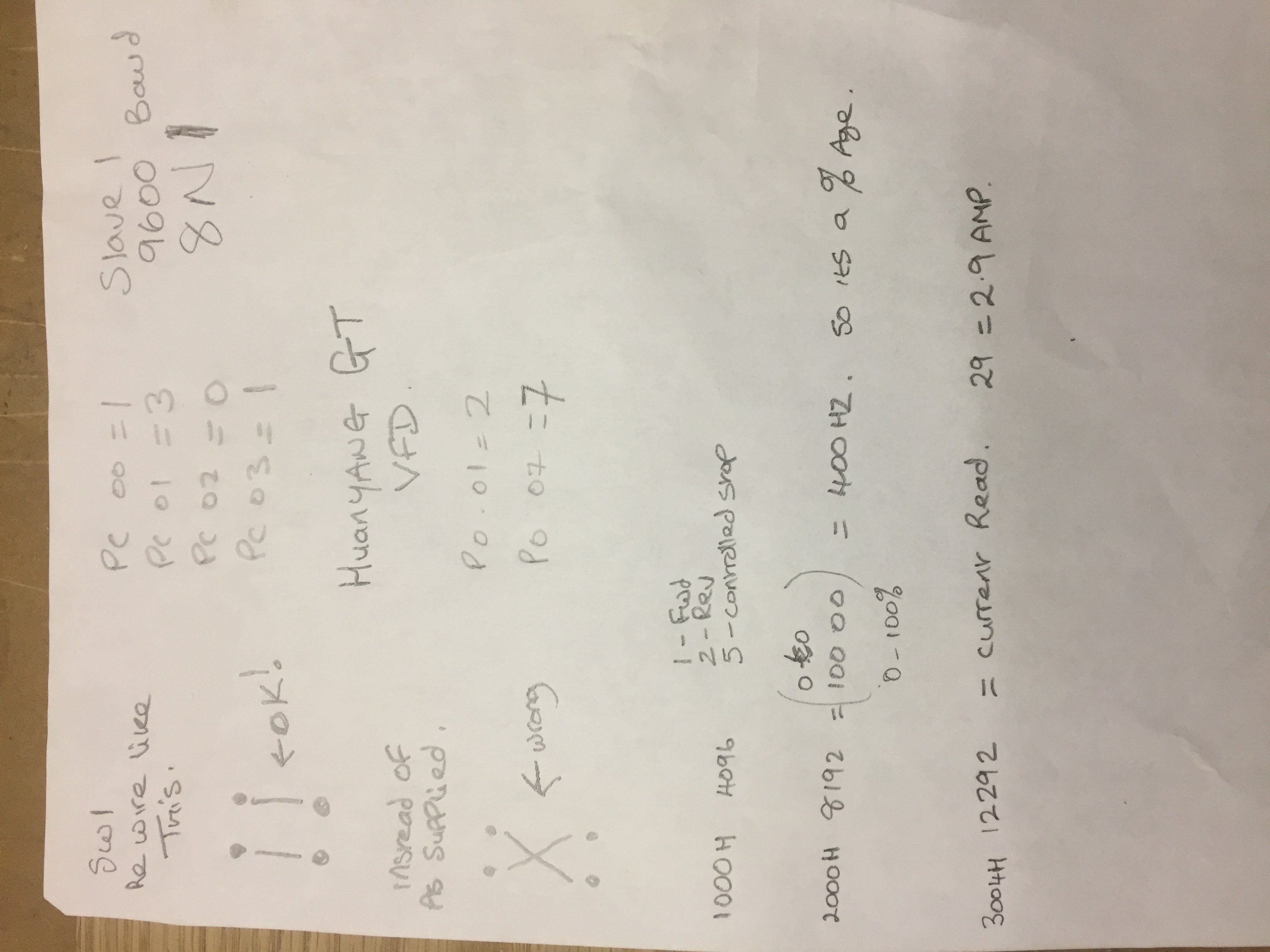

Postby Battwell » Fri Dec 08, 2017 4:11 pm
Correct settings

Battwell wrote:
The attachment IMG_3747.JPG is no longer available
Correct settings
Battwell could you please do me a favor and test the current read in Modbus V15 plugin.
I know control works well been tested/used for weeks but I had the read being sent wrong and hoping you could check with plugin below'.
Using current draw register and put 10 in the divideby field.

Postby Battwell » Fri Dec 08, 2017 6:40 pm
no its got a value- but not reading amps register.
testing on ecogoo register is 3002h mapped to screen textbox i created 20010
