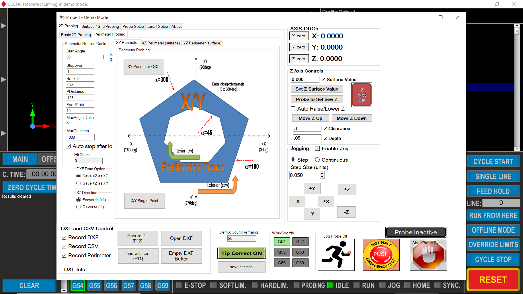

Postby Delco » Tue Mar 17, 2020 10:42 pm
Having a option for metric on first install would be good, I went through and changed most of the values to suit manually but I am still finding things I need to multiply by 25.4 to get within the ballpark :)
Here is how my install loaded attachment below , same on both my machines

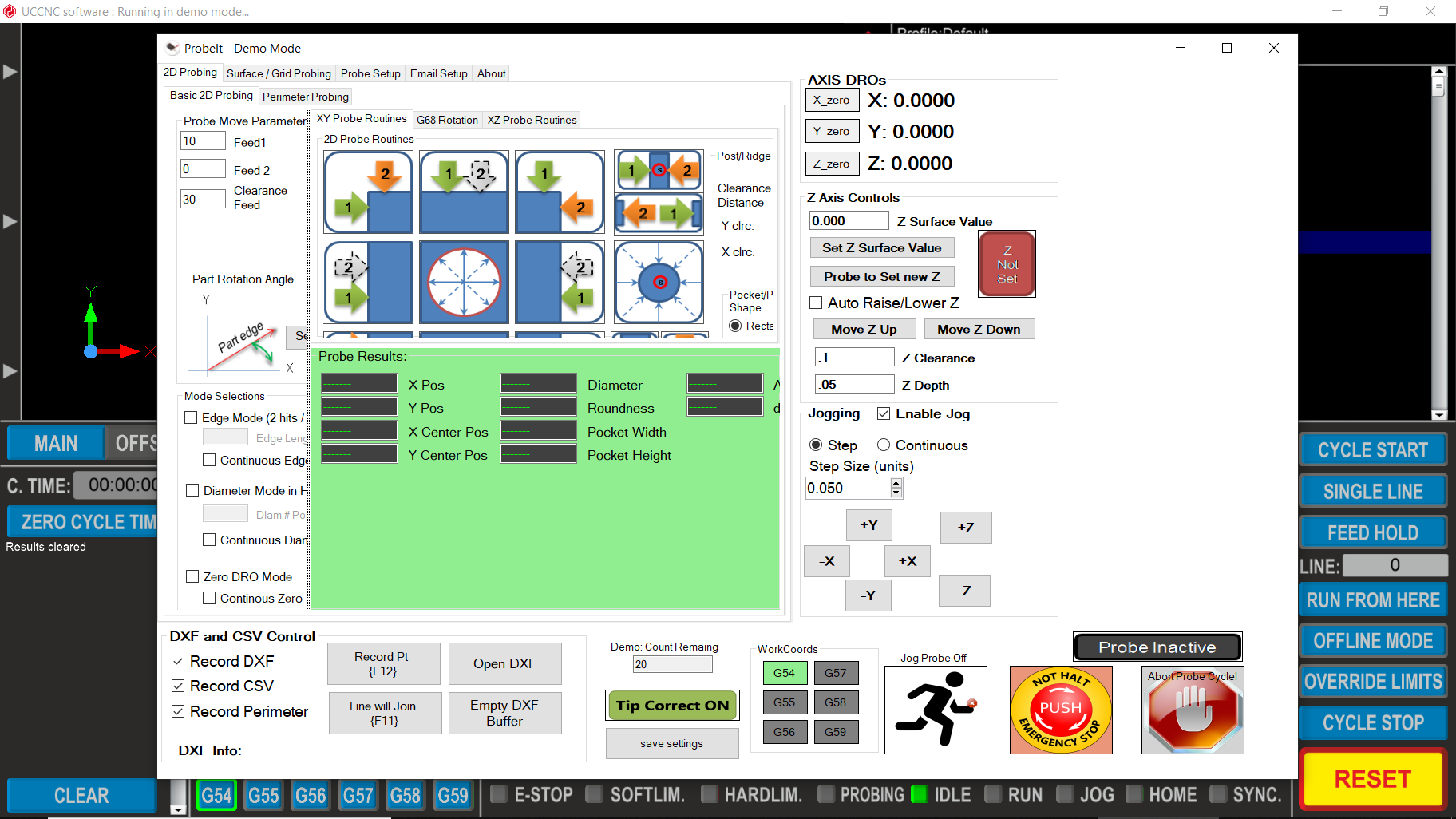

Re: ProbeIt for UCCNC
Postby Delco » Tue Mar 17, 2020 10:46 pm
Actually it loaded as below but then I switched to the basic 2d probing screen

Postby eabrust » Wed Mar 18, 2020 12:27 am
Delco,
Thanks for posting the screenshot, it is not loading properly for you for some reason. The controls in the 'right column' should be aligned with the abort button on the right side.
Here is a short video of how it should load, and this is how it loads for me, every time on both Windows 10 and windows 7. I also tried playing with screen resolution and screen scaling, and wasn't able to duplicate it looking like that.
Can you tell me anything about your screen resolution, what version of windows, etc you are using ?
I've also noted that sometimes when I compile the plugin, it will look weird for me (sort of like what you show, but not exactly the same), but if I just recompile it, it will then look fine. Not sure if Vis. Studio glitch or what, but apparently I can't use the fact it loads fine for me to verify it will load fine for everyone else yet..., so thanks again for your help pointing it out.
Postby thegreatwaldo » Wed Mar 18, 2020 8:04 am
Hi Eric
The same screen as Delco opened on my system when I had the text scaling set to 150 in windows 7 screen resolution. When I set the screen resolution to 100% it opened correctly, so it looks like windows scaling could be the problem.
Cheers
Andrew
Postby ger21 » Wed Mar 18, 2020 11:18 am
I do have txt scaling set higher on both machines though
How high?
Text scaling can wreak havoc with programs, especially ones with buttons and textboxes spread around the screen.
