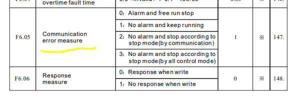

Postby Tobe91 » Thu Oct 31, 2024 9:47 am
Does anybody know what is happening, if there is any error or communication break down?
Does the plugin recognize this and stops the execution of the current program?
I didn't find any information about this in the thread.

Tobe91 wrote:Does anybody know what is happening, if there is any error or communication break down?
I think it depends on your vfd settings
- YQWQ
