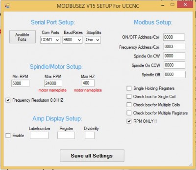

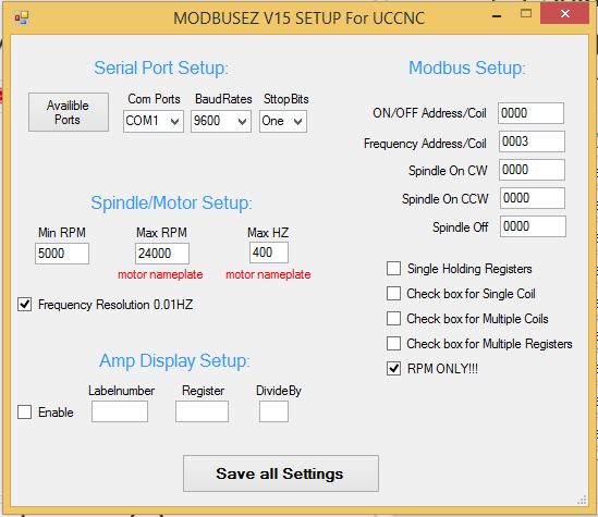

Since your able to communicate with The "RPM Only" setting that's a sure sign that it use's the Modbus protocol. The RPM Only setting in ModbusEZ sends a Modbus function code(6) holding register. To try and determine the correct register for on/off without help/info from the manufacturer would be nearly impossible. They shouldn't be advertising Modbus as a feature if they don't supply this info IMO.
I see from your pic you posted you are using a older version of ModbusEZ. When I first written this plugin it was a lot of copy/paste from the HYplugin than edited, probably why so many different versions. Fixes as I went.
I rewritten this plugin from the ground up, fortunately this time I had two local buddies with different VFD's (Hitachi, Delta) testing and didn't have to wait for anyone to download and report a problem. They been using daily for over a week so I just sent them the final version with the read implemented back in so want to give them at least week of use/testing before uploading on Zone.
I strongly suggest you switch versions since I was a lot more knowledgably with C# and Modbus this second time around.
Following what you posted you will need to checkbox for frequency resolution 0.01HZ. I left the "Amp Display Setup" header since IMO is the only useful register worth reading, but can be used to read any holding register.

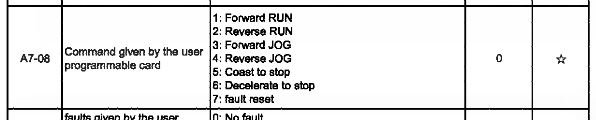

Looking at the manual for the 9600 Ecogoo seems to have a bit more info, I wouldn't think it would be much different than the 9100. It has a page of different monitoring registers.
I also found this, star on write means it's writeable.
The link to there site for manual.
https://pan.baidu.com/s/1jHPrTfo
Re: MODBUSEZ Plugin
Postby Dan911 » Mon Dec 04, 2017 6:44 pm
Modbus output holding registers are from 40001-49999
A708 hex = 42760
When you have time try A708 for you on/off register and 0001 for CWon............ and 0006 for Stop
Single Holding Register checked
Think that should work.

appears to be exact same address for run as hy gt series . 1000h = 4096Decimal . i set this to 1 it runs , 5 it stops 7 resets fault
at freaking last im getting somewhere!!!
2- CCW ?
6 -deceleration Stop?
Re: MODBUSEZ Plugin
Postby Battwell » Mon Dec 04, 2017 9:52 pm
5 stop
2 ccw
1 fwd
7 reset fault.
amp readout 3002H 12290 Decimal ( different to hy. i read in the row of 16 and matched it to vfd current reading ) :-)
all read in and tested using the standard uccnc modbus interface
and the most important for me with atc spindle- running status. 1001h 4097 decimal . readback 1h =running fwd, 2h= running reverse, 3h= standby, 4h=fault, 5h= poff
