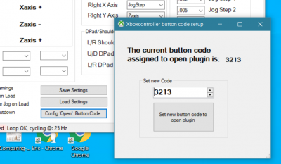

Sorry if this has been discussed but after scrolling through a couple of long posts I could not find it.
It has been suggested that you can set an onscreen button which will call up the configuration window for the Xbox controller.
I can't seem to work out how to do it. Have done plenty of screen edits in the past so I think I grasp the basics.
Setting a button and assigning it number 1234 does not seem to do it for me.
Thanks in advance.
Greolt
Posts: 262
Joined: Sun Sep 04, 2016 6:22 am
Re: XBox 360 plugin update
Postby eabrust » Fri Feb 04, 2022 12:18 am
Hi Greolt,
If you're talking about setting a button code using this config window for the plugin:
That is only for initially opening the plugin should you not have the plugin set to show on startup w/ UCCNC. I can look into making the button press code also bring the window out of minimize/hide mode, but it currently doesn't do what I think you're trying to do.
Currently, Once the plugin is running/open, then if you minimize it it hides in the system tray as an icon. It's the system tray icon that you use to bring the window back for now.

Postby Greolt » Fri Feb 04, 2022 6:11 am
Thanks Eric
Now I understand its purpose.
The way it works is fine.
Greolt
