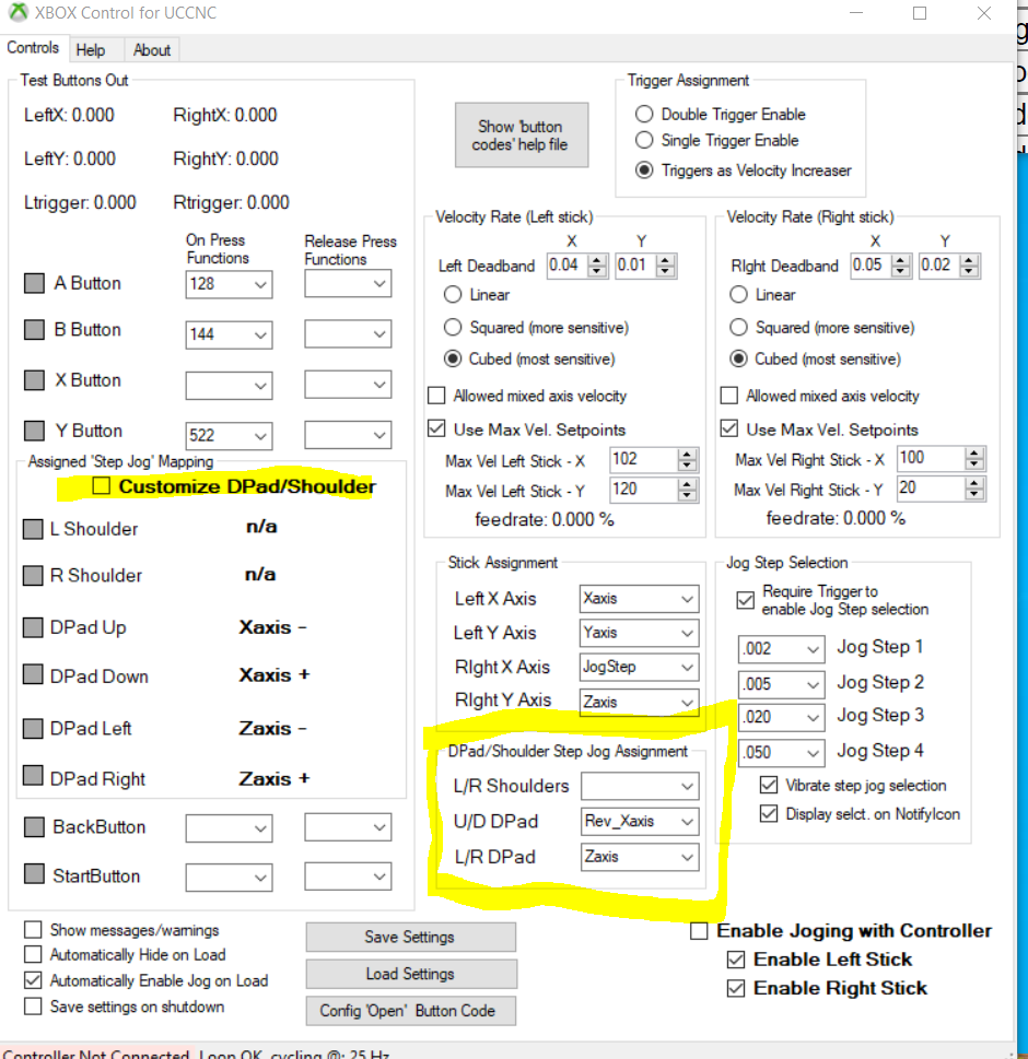

Postby eabrust » Fri Apr 09, 2021 2:36 am
Hey Ralph,
Going by what you typed, you might have your numbers crossed, #147 is canceled by #229, and #148 is canceled by #230. Ie, you start a +x move, and try to cancel it with a '-x stop'
You can also just un-tick the 'customize' box to use DPad/Shoulders for step moves, and select which axis/direction you want assigned to the l/r, up/down buttons.
I run all my machines using the xbox controller, and keep the 'customize' unticked so the DPad is just defaulted to step jog.
Hope this helps
Regards
Re: XBox 360 plugin update
Postby eabrust » Fri Apr 09, 2021 2:41 am
I also forgot to mention, #147 and #148 (and all the rest of the jog starts) don't define if the jog is step or continuous, it is just a 'start' button, so step or continuous has to be set and maintained for what you want. if 'step' gets changed to 'continuous' inadvertantly, the dpad won't give you step jogs even though that might be what you want.
But if you have the 'customize' box unchecked, the plugin forces 'step' mode on presses of the dpad and shoulders, so you will always get 'step' movements.

Postby spumco » Fri Apr 09, 2021 2:43 am
Well, now I feel dumb.
Didn't even see the drop-down for the non-custom Dpad setting. It defaults to a lathe-like X/Z arrangement so I just went straight for the custom option without seeing the pick list.
