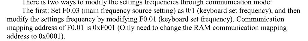

Dan911 wrote:Alex please look at snip I taken from your manual, your configured for second option using frequency address 1000 and your VFD is not going to accept the format ModbusSZ plugin is sending frequency.
You need to use first option using frequency address 0001. There's also a setting in your VFD for frequency resolution (F0.02) 1- 0.1hz and 2 - 0.01hz. If F0.02 is set to 1 than don't check box in ModbusEZ "Spindle Setup"
Use the new final V15 plugin I uploaded in previous post.
The attachment PT manual.JPG is no longer available
Your frequency address needs to be set to>>>>>>>>>>>>>>> 0001
Read the quote for frequency resolution, make sure that ModbusEZ corresponds with VFD settings.
Your VFD needs to be set to Keyboard sets frequency see snip of manual below.
