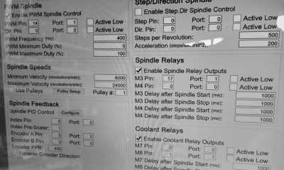

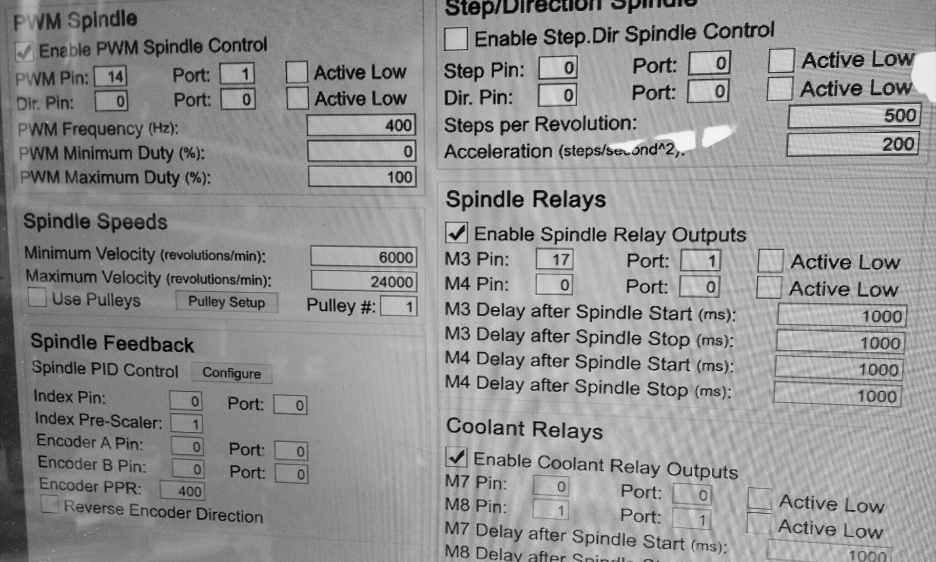

Dan, could you give more details to how to change the text field to the new number. I am still trying to get speed control from the computer with my Huanyang VFD. Does changing that perimeter effect all types of speed control, or just the RS485 dongle. I've been trying to use the Leadshine MX4660 controller to handle speed and i fear that I am combining the two settings.
I had seen in older posts about the plugin that a screen popup would tell you that you have connection with the VFD. Is that still there because I have yet to see it. Even when I have been able to get some speed control the 2017 screenset doesn't show the RPM (nor does the spindle talker app).
Yesterday I could get some speed control when using the MX4660. I had the issue that when the loaded program called for 10k rpm the VFD showed F275 (16K?)and when I moved the slider on the screen down the speed would increase (at 54% of the 10K the VFD speed up to show F359 and at 150% -F161). Then I changed something and now only have a F120 with no ability to adjust the speed!!
I will attach a spread sheet of current settings and screen shot of spindle setup page.
