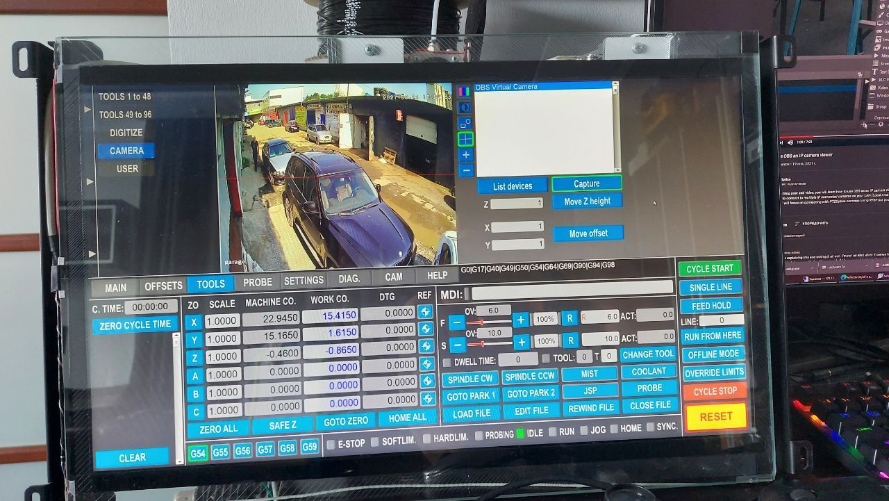

Re: Camera plugin crosshairs?
Postby mutumbo » Thu Aug 26, 2021 8:08 am
silverdog wrote:Would it be possible to use an IP camera instead of a USB camera?
for forwarding ip to virtual webcam I used OBS studio
mutumbo
Joined: Sun Jul 18, 2021 7:29 pm
Postby mutumbo » Fri Aug 27, 2021 4:41 am
screenshot
