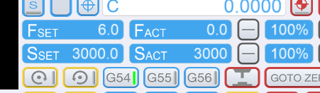

I have just used the standard screenset. I have the Sact field set in Plugin and Screenset to 20050 as suggested.
When I activate the start spindle button, I hear a relay activate in the VFD, the button has the green indicator to show active - motor does not start. When I de-activate the start spindle button, replay drops.

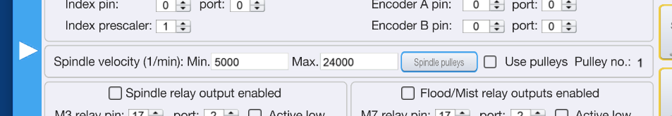

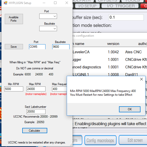

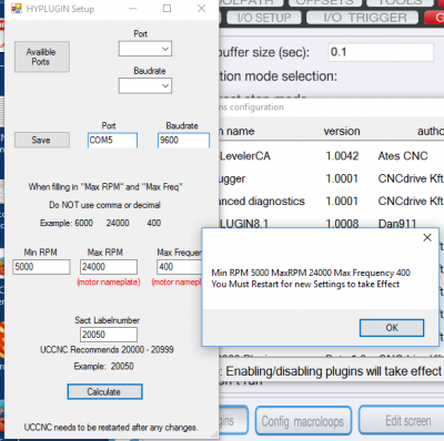

Gorden did you hit calculate button and restart after change? Please try this than restart, than Go to Configuration/Axis setup/Spindle and confirm min and max RPM. Plugin should of set these to the min and max you inputted in HYPLUGIN8.1 setup. Also double check spindle pulley box is not checked.
Re: Huanyang Plugin
Postby zymurgy42 » Sat Feb 25, 2017 2:33 am
Updated DLL with 5000 as minimum. Closed UCCNC, restarted.
As you can see, mirrors choice.
I have been abiding by the prompts all the time.
Gordon.

Hmmm, I'm stumped. No need for screen shot but you are getting the connected and responding window? Getting this window makes it even more baffling
How the plugin works is it test by sending a spindle stop command on start up and if VFD replies you get the Connected and responding window. If the VFD don't reply at any time it will continually send command up to 5 times if still no reply sends stop command and window "VFD stopped responding".
It seems all is working with plugin for you except setting the frequency(RPM). The relay click you here is spindle on and click when off. I normally would think its a problem within the plugin but others including myself is using the same 8.1 version you are.
