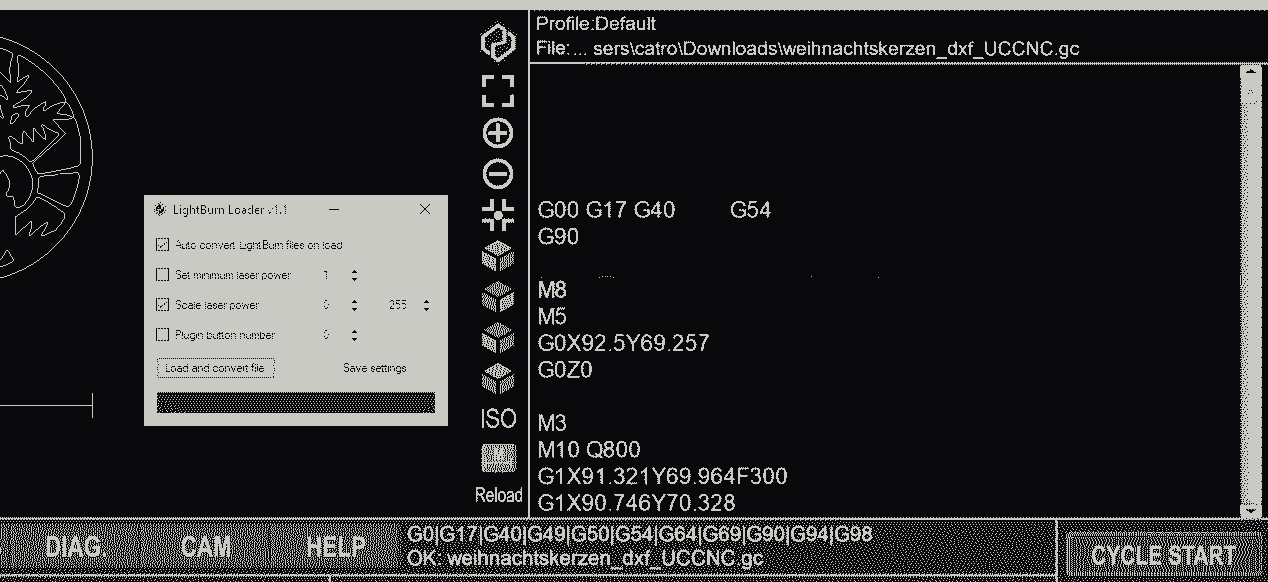

I've tested your loader on a simple file but it set the laser power to 800 (80% in lightburn).
Using the scale option (0 to 255) doesn't change anything ...
See the image attached

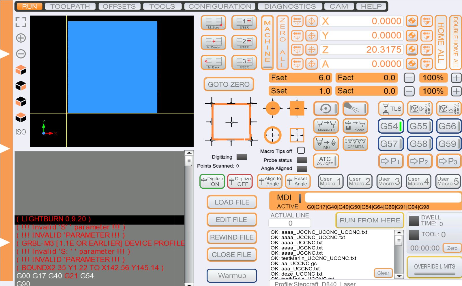

Sorry i try to understand what you mean but i only get a blue screen in uccnc that what he goes to laser so only horizontal lines and no photo.
I hope you want to help me out, i try the do my best but i cannot find the problem what i do wrong.

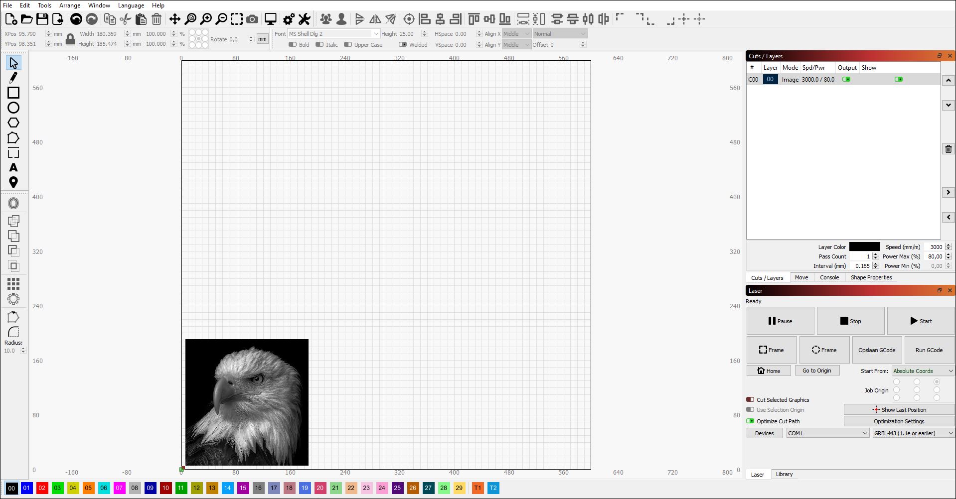

Could someone help me I can't manage to convert a photo that I have loaded in lightburn into gcode
that I can load in Uccnc lightburn plugin.
All I keep getting is a blue screen and I can't see anything. What am I doing wrong now????
This is only what i get.
I have try what i can but only the blue horizontal lines.
I hope that anyone can help me with a step by step how to do it.

Postby Robertspark » Sat Jan 29, 2022 7:36 pm
thats because uccnc shows the PATH, not laser intensity

Re: LightBurn loader 1.0 (new) - New plugin to convert Light
Postby cseyler » Sun Jan 30, 2022 7:57 pm
You can only see the picture when you use the Laser Engraver plugin.
Lightbuirn generates a gcaode, slightly modified by the lightburn plugin. But it remains toolpath (blue line).
