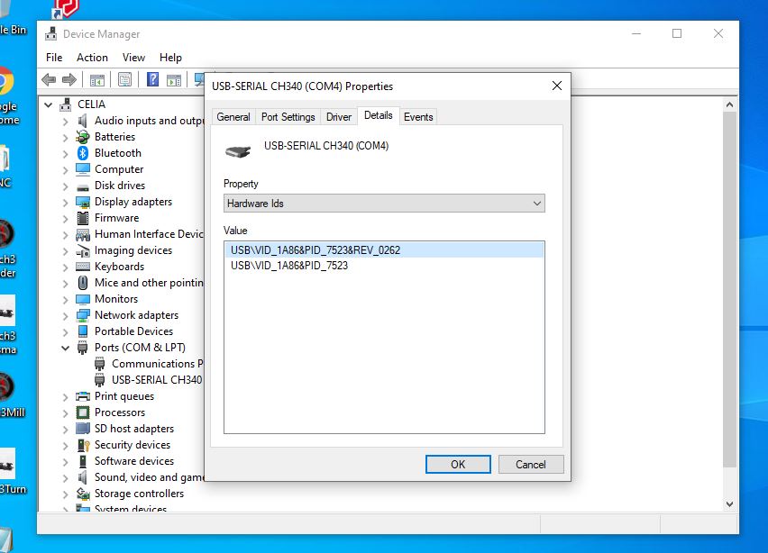

Postby Robertspark » Sun Mar 29, 2020 5:55 pm
Do you have the 4 or 6 axis mpg?
Do you have the wired or wireless mpg?
All of these are not likely to use the same plugin because of the PID being different I expect. It may be worth while you checking and listing your VID and PIE for the usb device as they may be different to what the plugin was created for to slow Andrew to check out the potential problems

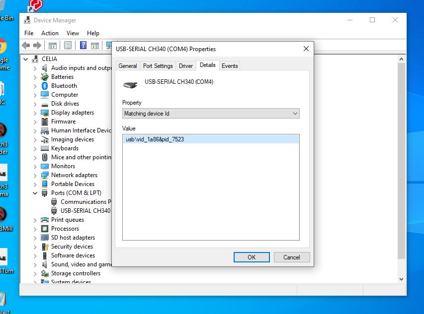

Re: WHB04B-4 Pendant Plugin
Postby formantjim » Mon Mar 30, 2020 1:39 am
Hi Robertspark thanks for jumping in here.
The pendant in question is 4 Axis and Wireless. As I said earlier part of it works like in step mode but in continuous there is no axis movement when the wheel is tuned on the pendant. It does communicate bidirectionally and reports the correct readings on the DRO's.
Attached are the details of the VID hope this pinpoints the issue.'

Postby shad » Mon Mar 30, 2020 6:51 pm
Has anyone besides formantjim tested the plugin?? Any feedback will be fine:)
About usb - this MPG has a :
ProductId = 60307;
VendorId = 4302;
Try attaching program for checking
Starnge, but on all my PC's it's working fine.
