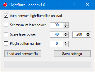

It's super easy. Just enable the plugin and restart UCCNC. If you show the plugin window then you can set some options:
If you tick Auto-convert then the plugin will watch for a fresh loaded file and check the first line. If it starts with "; LightBurn" then it converts the file for UCCNC and saves it besides the original file with "_UCCNC" added to the file name.
The Set minimum power option does what you think: instead of turning off the laser (while moving to new position) it sets a minimum value.
The Scale is the same logic. LightBurn outputs 0..255 to control the laser. You can override this to e.g. 30..200.
The 2 options above can be used together.
With the plugin button number you can assign a button code to show up the plugin window. (You place a button on the screen and set its buttonnumber property to this number.)
Don't forget to save your settings.
You may also choose to start the conversion manually: turn off auto-convert and press Load and convert file.

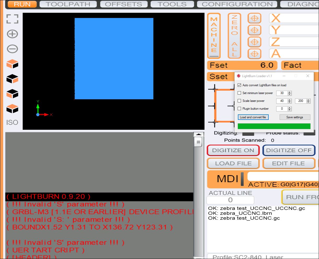

Postby andre99 » Wed Aug 25, 2021 9:45 am
Here you see i have used a photo of two zebra's but i only get a blue straight lines
i first download your .dll an placed it in the folder you say.
But this problem i don't know what i do wrong
And there is a error in the file look below so i do not get any picture in the top screen as it must be.????

Postby MikeC » Fri Aug 27, 2021 3:36 pm
andre99 wrote:What must be the extension of the saved file is that .lrb ??
I want to used to laser photos on to tiles in sticky mode and passtrough.
Is that possible?
Further must i make a choice to with controller in the beginning.
Is that Grbl ore grbl3 ore a nother one ?
.lbrn files are Lightburn save files and do not contain any Gcode. To make use of lightburn with UCCNC you have to export GCode
I have no experience engraving photos using LB and UCCNC however, you may be better off using UCCNC's inbuilt laser module for this type of laser use.

Postby MikeC » Fri Aug 27, 2021 4:05 pm
You should also check the S-value max set in LB (Device settings) as it sounds like the pluggin is expecting a range from 0-255 and i'm not sure what the LB default is.
